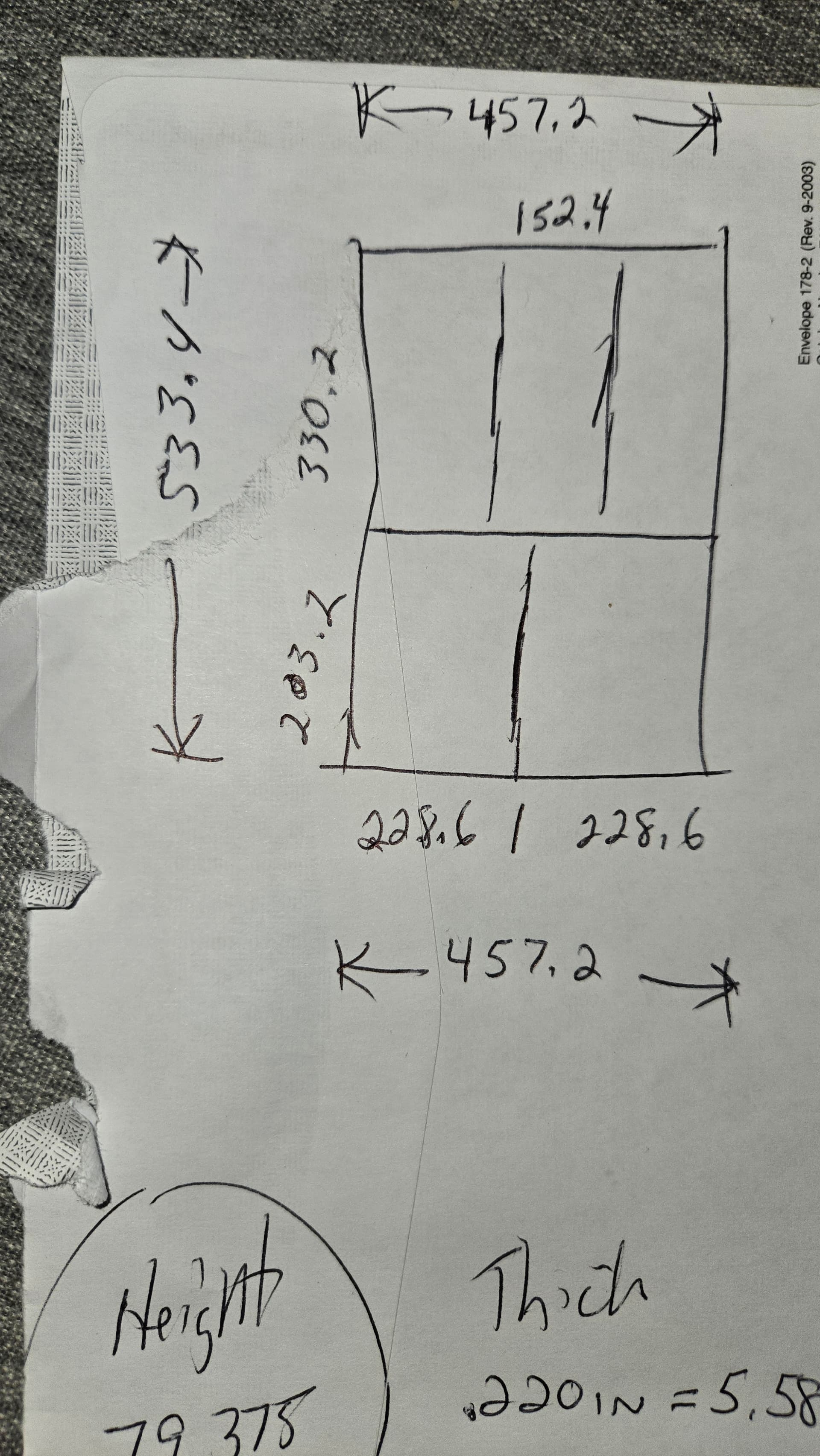

Can someone help me as boxes.py help is the worst. Im trying to make a tray layout 3 sections 153w x330L in the back and 2 sections 228.6W x 203.2 L in the front
… when I try to save it, I get errors. It works fine till I edit removing dividers I dont want then I get

This is rough of what im trying to make…
It can be done by modifying the dashes, plus, hyphens, etc after input Sx,Sy per their own page.

Part of the problem may be in the different total widths:
  • 3 sections 153w x330L = 459 wide
  • 2 sections 228.6W x 203.2 L = 457.2 wide
Using a 459 mm overall width and 533 mm length:

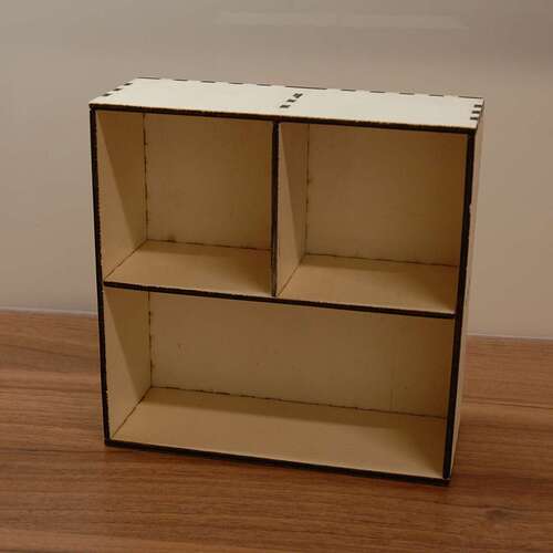

Which turns into this:
Although I haven’t built it, the pieces look plausible.

Is it possible to divide the top by 3 instead of 6 or are you trying to use a multiple? My box works until I remove dividers in the little diagram. I dont know if Im to remove +/- and add - where no connection, and + where there is one.
It seems the total number of sections must be a multiple of the sections in both parts. In your case, that’s 6 total sections = 3 × 2.
Then you knock out the walls you don’t want in each part, with the remaining walls aligned between the length markers along the top of the diagram. In your case, that’s minus three walls in the upper part and minus four walls in the lower part.
Basically, you can remove an existing wall from the initial layout, but you cannot add or move a wall.
Again subject to learning something new, a wall that does not align properly with the length markers isn’t allowed, because The Algorithm did not compute the position of that wall when it generated the initial layout.
