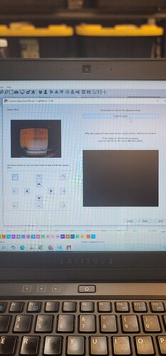

Lightburn camera alignment falcon a1
Ok new falcon A1
Calibrated the camera lens no problem.

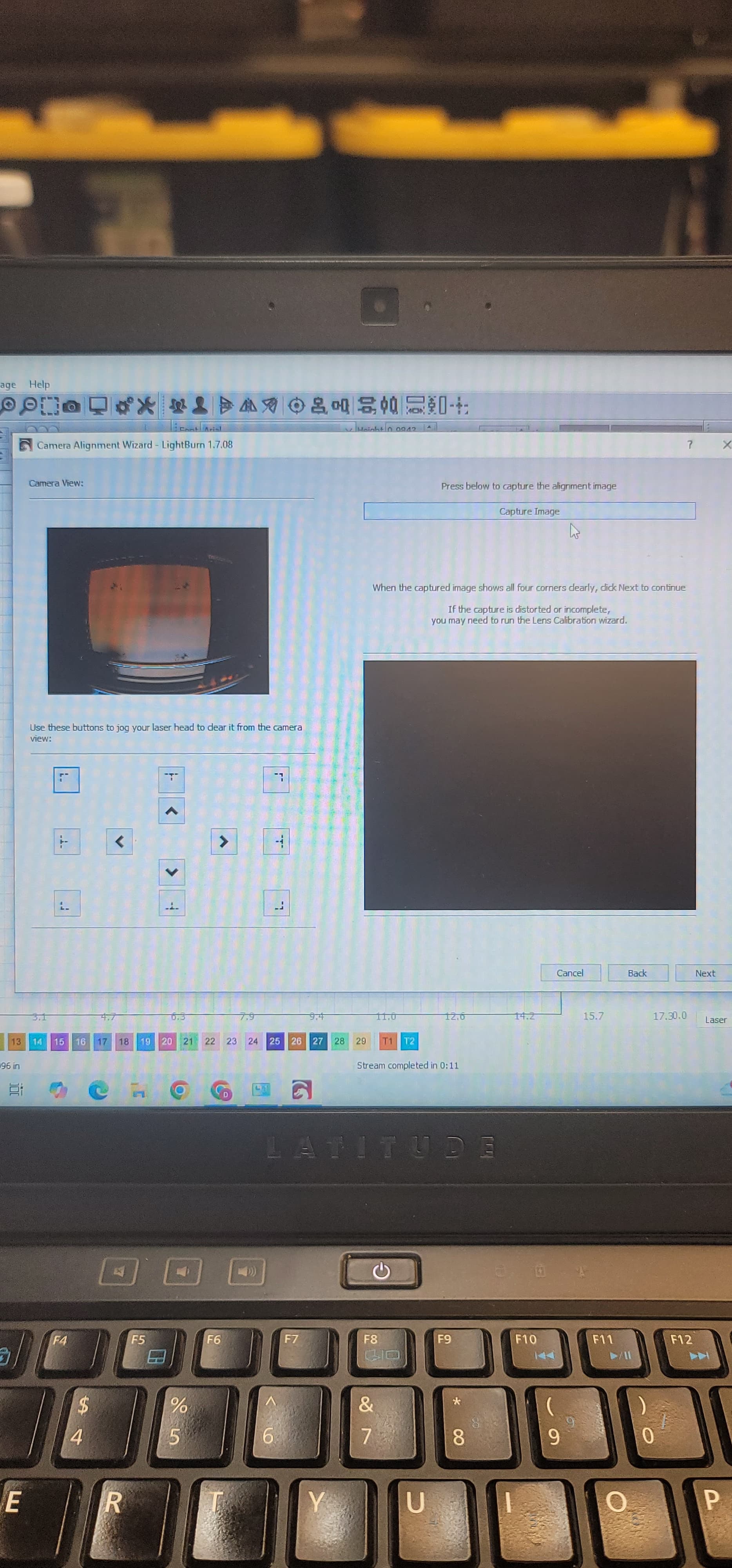

Burned the image for alignment. Lightburn won’t capture or show image.All window permissions are granted for the camera, switched USB, windows 10, rebooted, updated, disabled and uninstalled drivers…ugh help
Did you try switching the capture system in main settings?
Yes tried on it both custom and default settings. Went through every setting I’ve thought of even running the program as administrator.
Assuming you fixed this, but for people in the future, I thought I’d post what fixed this for me
Short term: change input camera from none to falcon A1 before running the alignment
Long term: enable legacy usb support in the bios, the camera appears to fall asleep otherwise
