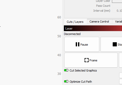

Lightburn displaying framing instead of ready on galvo laser
light is not displaying (ready) when connected to my 60 watt galvo laser (framing ) is being displayed instead cant get laser to work

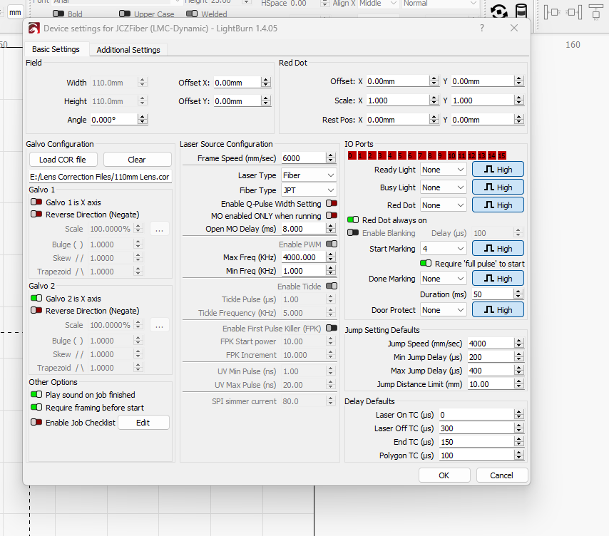

Please tell us more about your Galvo Laser. Power capacity, Source type, EZCad version… etc.
Have you swapped the driver from the EZCad 2 driver to the driver that LightBurn uses?
Have you imported the Markcfg7 file into LightBurn?
yes mark7config file imported
ezcad version that fine with laser 2.14.11
company is DOWIN LASER
LASER IS 60 WATT JPT MOPA

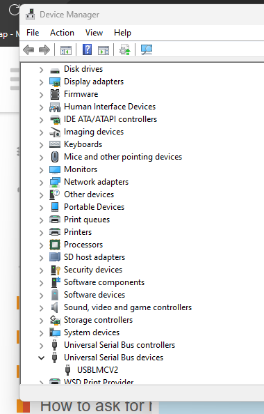

LIGHTBURN Driver shows up in device manager

Having a fiber and a few other types of lasers, the accuracy of the focus always surprises me… So ensure you are properly focused… If this is off by much, you’ll see no work done by the laser.
If you have a JPT MOPA, then you want to enable q-pulse width setting. If you have a foot switch, is that working… ?

On Windows, the driver for EZCad doesn’t work with Lightburn.
Good luck
foot switch works in ezcad
and driver in device manager for lightburn is active
Great, if Lightburn can talk to it, you’re fine…
Did you enable q-pulse settings… that’s part of what you’re paying for with a MOPA.
still no response from laser ,

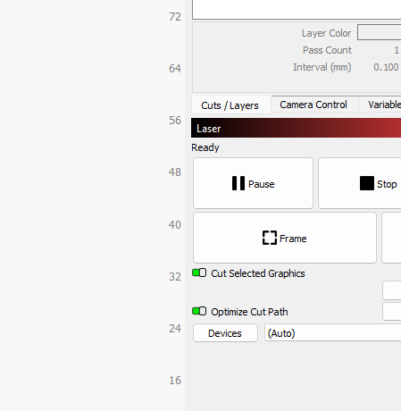

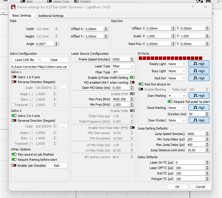

for some reason i discoverd it works with laser type set to RAYCUS YET I HAVE A JPT, LASER CONSOL NOW SHOWS AS (READY)

I’d be interested in looking at your Markcfg7 file and your lbprefs file.
Please make a copy of the markcfg7 file, and change the filename to markcfg7.txt and drag and drop that file into a reply here.
In LightBurn, click File, then click Export Prefs and save that file somewhere convenient.
Please drag and drop that file into a reply here as well.
I’ll import the markcfg7 file as a new profile and compare it to the Settings (for the Raycus and the JPT) that I’ll be able to see in the lbprefs file.
