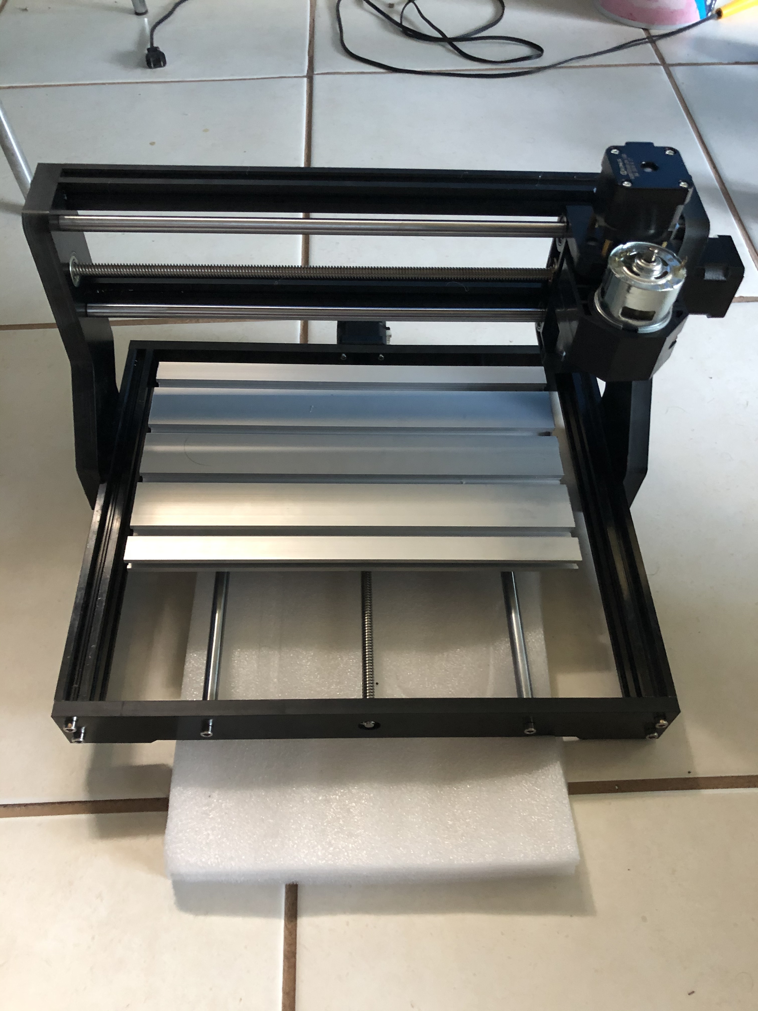

Here is a picture of it
Sorry, but this image doesn’t address the needed information. You identified previously (post above) that you could get LightBurn to talk to this hardware. What is reported in the LightBurn ‘Console’ window when you connect?
