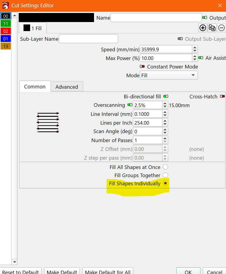

I’m an old man and well out of my depth here… At some point I stumbled into how to change the Etching Pattern from the Laser sweeping side to side - and taking a lot of time - to etching individual letters, patterns, etc. - reducing laser time… I cannot for the life of me find out how to do it… I have been thru the Device Settings and Machine Settings menu’s as well as Preview and truly am lost as Last Years Easter Egg… Any aid or advice would be greatly appreciated..
Thank You, John R. Petrea

Maybe you´re searching for this:
 ![image](https://forum.lightburnsoftware.com/uploads/default/original/3X/2/b/2bc764553a828dd0ca1f1b6f4528e50ce78871cd.png)
> **[Fill Grouping - Fill Mode - LightBurn User Guide](https://docs.lightburnsoftware.com/latest/Reference/CutSettingsEditor/FillMode/?h=fill+shapes+individually#fill-grouping)**
> Closed Shapes Only | Setting a layer to FillMode tells LightBurn to fill in the closed area with parallel lines.

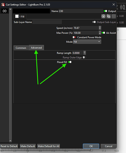

Double click on the layer in your CUTS/LAYERS window.
Then click on ADVANCED tab
Then select FLOOD FILL
Use the PREVIEW command (CTRL+P) to verify.

Thank You, JimNM, I clicked on several of my layers and didn’t get a window/menu like this in Open Cuts/Layers… Tried clicking on the Cuts/Layers in Window menu to no avail either… THank You

Parsec FerAS,
Thank You for this information… I believe this si what I want but I cannot find that menu or window… Where is it hidden??

Double-click the Layer color in the Cut/Layers Window. The layer must be set to Fiil mode.

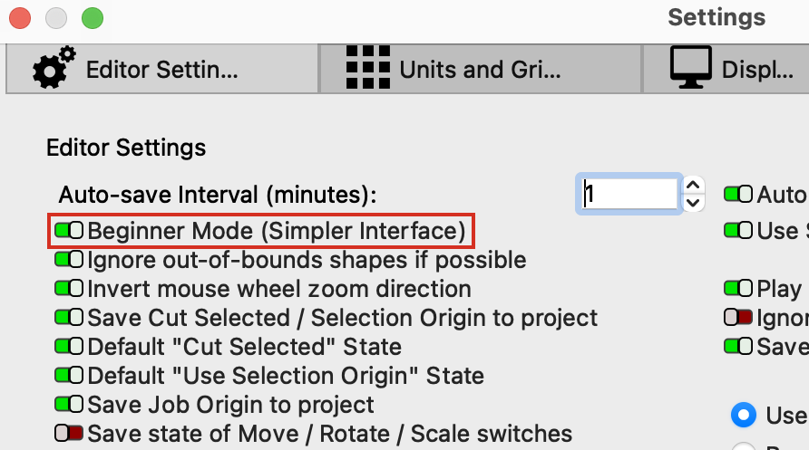

You might be in Beginner Mode. [Beginner Mode - LightBurn User Guide](https://docs.lightburnsoftware.com/latest/Reference/BeginnerMode/?h=beginner+mode)
You can disable it in the Settings window.

Colin,
Thank You… I checked and I wasn’t in Beginner… Just not clicking the right place as Parsec had instructed… Appreciate your feedback because I am not reall good with this stuff…

**Author:** ![JohnBoy1880](https://forum.lightburnsoftware.com/user_avatar/forum.lightburnsoftware.com/johnboy1880/32/100060_2.png) [@JohnBoy1880](https://forum.lightburnsoftware.com/u/JohnBoy1880)\
**Post date:** [August 10, 2026, 9:33pm UTC](https://forum.lightburnsoftware.com/t/lightburn-etching-pattern-change-from-side-to-side-to-individual-item/191758/10 "2026-08-10T21:33:27Z")
</div>
Parsec,
I got it finally!!!.. Now I just have to remember it for the next time!!.. Appreciate your help and feedback so quickly…

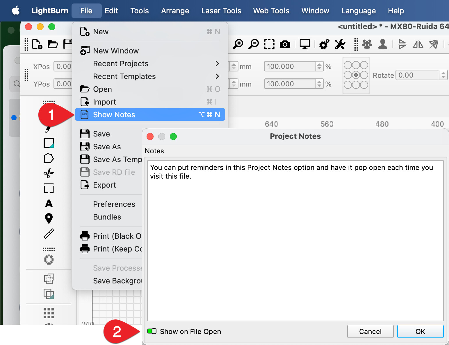

> [@JohnBoy1880](#):
 ![image](https://forum.lightburnsoftware.com/uploads/default/original/3X/2/4/24947b8119c679ac92d80a49cba0a7998c70798c.jpeg)
