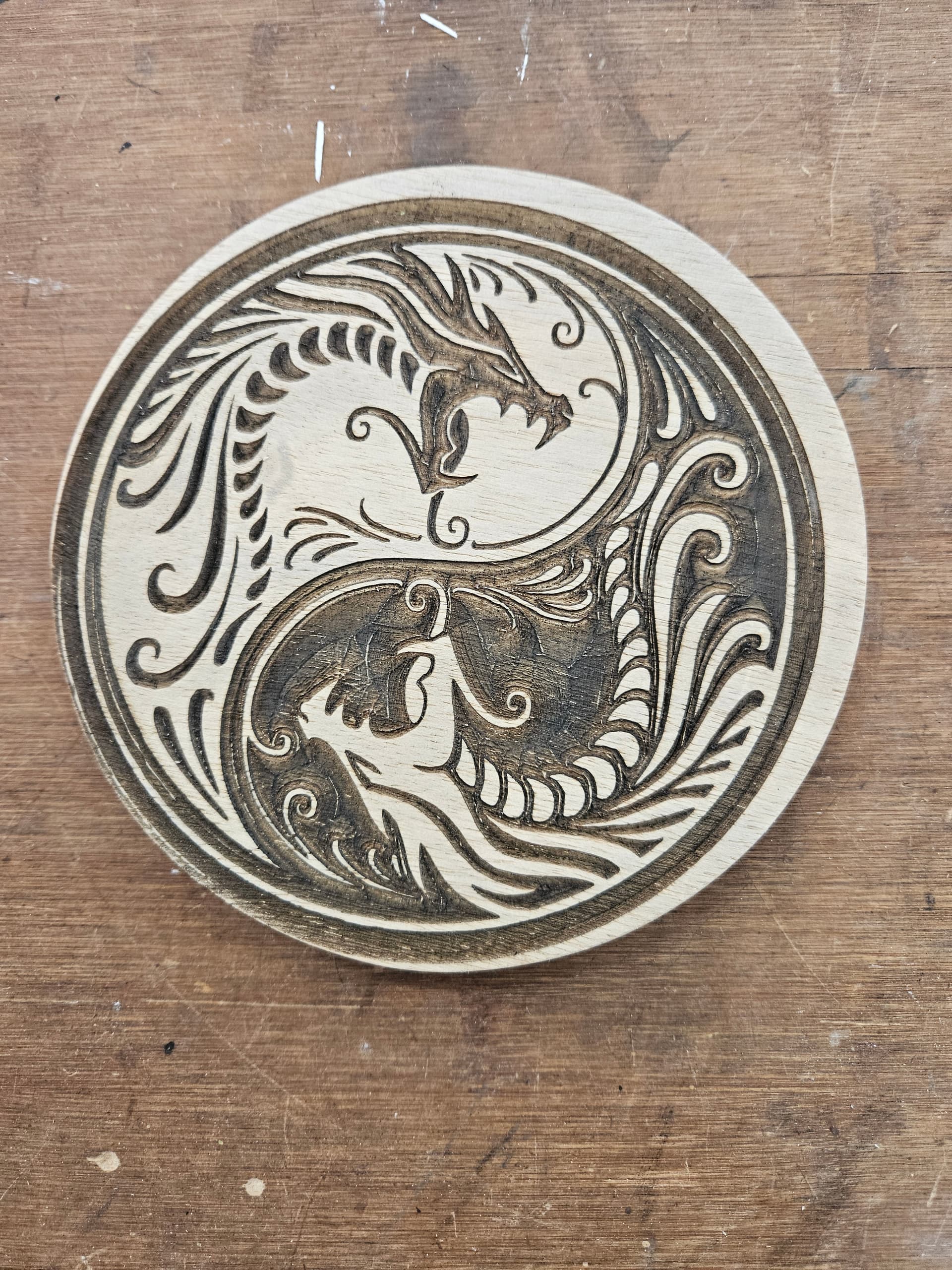

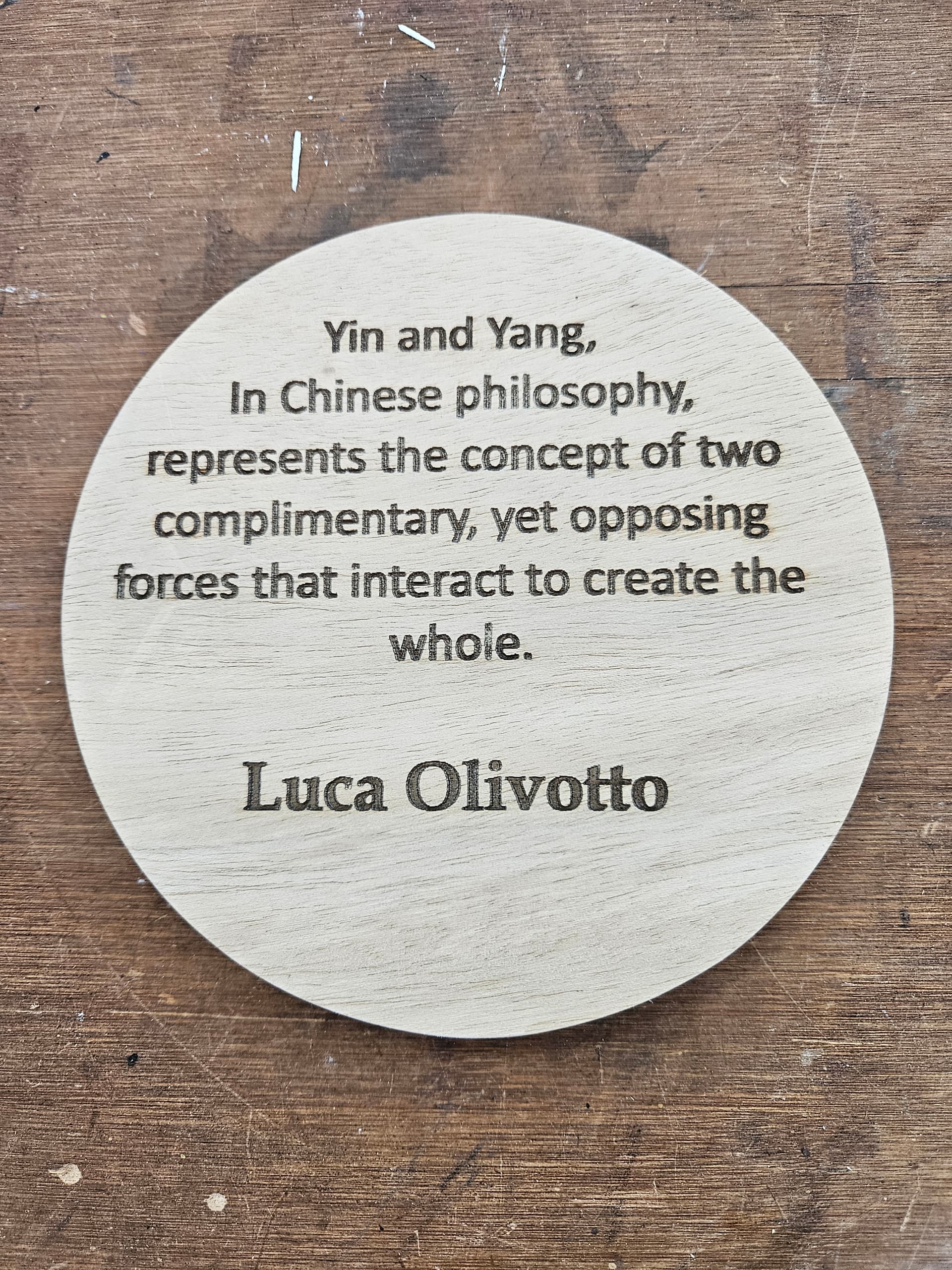

Hello all. I’m trying to burn a project for my Grandson who is into martial arts. The project is a 6" circle with a dragon Yin Yang on one side of the circle and a definition of a Yin Yang on the opposite side with my grandson’s name. The issue, I carved the definition on the back with his name and the carve went fine. When I carve the dragon Yin Yang it’s offset in the circle. This has happened twice now, both times I get the wobble carving the Yin Yang. I’ve checked my center and re-checked my center and it’s dead on for both sides. I even created a jig with a 6" centered hole to hold the circle blank, no luck.
My machine is a Longer Ray 5 with a 20w laser and I have an air assist.
Thoughts?

It actually looks like both are offset.

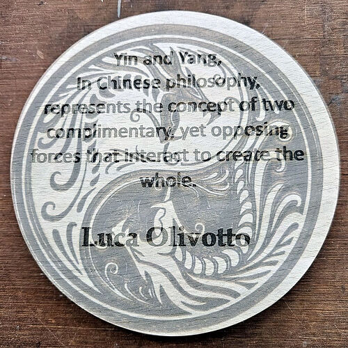

Rescaling the photos to the same size and overlaying them with a bit of transparency suggests both engravings are off to the left by about the same amount:
The ends of the text lines are closely aligned with the circle just inside the border, so the centerline of the text block is pretty close to the centerline of the graphic: both are misaligned on the disk.
I like using the center as a starting point. Seems to work pretty well. Another possibility is there’s a booger somewhere in the file. a booger is a vector that is very small and hard to see.That would through off of the center point.
