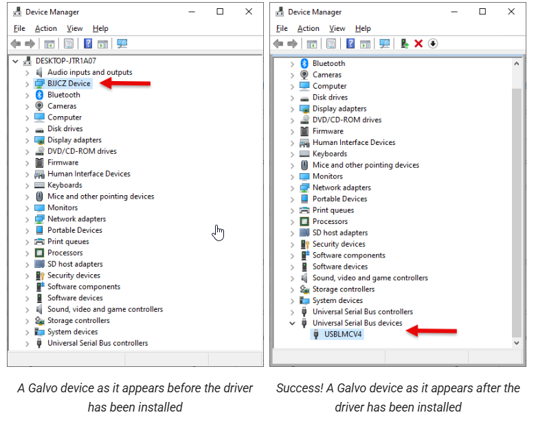

I have a Raycus JCZFiber Laser I purchased about 2 years ago. I installed lightburn to run the laser about a year and a half ago and have been using it flawlessly since. I recently purchased a new computer and bought a new license for Lightburn and cant connect to the laser or import the settings from the old computer.
did lightburn change something to not allow this laser type? how can i get access to the laser again? I would hate to have to stop using lightburn, but buying a new laser isnt an option.
Hello Eric
Can you confirm you did swap - correctly - the Ezcad2 drivers for LightBurn drivers?
I believe so, i clicked the ezcad2 option on lightburn install and did the steps there. i can try this again and uninstall the software.
This is the specific test to validate
The Laser must appear as USBLMCV4 once drivers are installed
