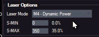

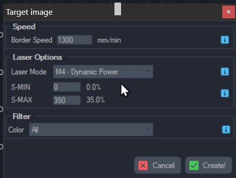

It could be variable power. LaserGRBL does not have it. It is always in the Constant Output power mode.
I know you said you had Constant in both, but there has to be a difference somewhere. LaserGRBL is often recommended as a test comparison to Lightburn.
The first thing is to check the gcode. You can export the generated gcode from LB and compare it to the code generated by LaserGRBL. Check the differences.
Just FYI: LaserGRBL has both modes, it just calls them M3 and M4, which are the firmware commands.

The image showing M4 was only to show that LaserGBRL can use variable power and was not used for the tests
Now we all know. :grin:
The only difference I see between the G-codes is the M5 command, which should not affect anything. I don’t see why the laser should have different power output between both projects.
The only thing I would change is that you selected the grbl-m3 profile in LB, which is wrong. You should use type “grbl” for your laser. Otherwise, dynamic power is not available at all.
