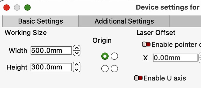

I suddenly have some strange behavior in lightburn, it’s now outputting the program upside down. The simulation shows it starting at the lower left corner but the program doesn’t come out that way. If I rotate 180 degrees, the program comes out right side up, but it starts at the top instead. I’ve been using it all weekend and it just now started doing that. I restarted, same behavior. I walked away and had lunch, same. I cursed at it and restarted again, nothing. Anybody have any ideas?
Have you possibly changed origin in device settings? Try setting this differently to see what happens.
Yes, I switched it from the lower left (where it’s always been) to the upper left, and now it’s outputting correctly…or at least the way I want it to. I’ve never understood the origin setting. Everything I do and have ever done has the origin in the center so I don’t know what this setting is actually doing. Every program I post, I get an error about out of bounds, but it’s not out of bounds. I just ignore the message and it and it works fine anyway. Thank you for helping me with this. I don’t know why I have to put it in reverse to go forward but at least I can get back to what I was doing.

I watched the video but it doesn’t address my problem. I have machine origin at lower left, and my job origin in the center with “user origin” Everything looks good on screen, and the simulation shows it starting at lower left corner of the job, which is what I want. But the program is ouput to start at the upper right, and the image is upside down. Now, I have an additional issue because when I import a photo, it comes in rotated 90 degrees to the left. I rotate it back upright, post a program, and it comes out upside down again. Everything I try comes out 180 degrees from what I want.
Solved!!! I went bug hunting and found that if I turn off “cnc machine” in device settings, everything is back to normal. I’ve never noticed that setting so I don’t know what state it was before. Or how, or when it got changed. But it seems cool now. Much thanks.
