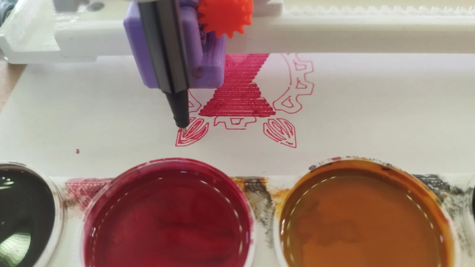

When cutting a shape, the z will raise then lower between shapes.
When filling a shape, if the shape has cutouts, the z remains fixed during traversal moves. Is there a way to force a z up then down during traversal moves in a fill?
Look at what happened to my beautiful unofficial SmashMouth tribute banner… Who will make it right? 😭

Looks more like laser didn’t shut off between moves.
<div class="post-metadata">
**Author:** ![Dr-Zee](https://forum.lightburnsoftware.com/letter_avatar_proxy/v4/letter/d/898d66/32.png) [@Dr-Zee](https://forum.lightburnsoftware.com/u/Dr-Zee)\
**Post date:** [September 7, 2024, 10:43pm UTC](https://forum.lightburnsoftware.com/t/lightburn-raise-z-for-traversal-moves/149310/3 "2024-09-07T22:43:40Z")
</div>
It’s a pen plotter. It keeps the pen pressed during traversal.

The issue is with the fill mode. When doing lines it behaves properly.
There are very few fill-mode settings, definitely nothing along the lines of "home and reset z between traversals.

There is no way at present to tell it to raise the Z during traversals with a fill.
