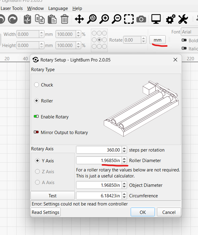

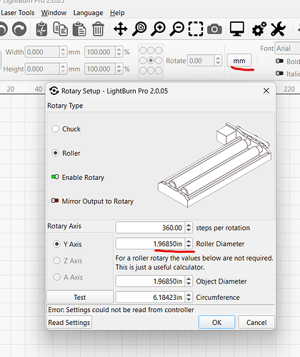

I don’t often use my Rotary, however yesterday when i went to use it I was unable to get the roller diameter to switch to mm. Is there a new setting someplace to make this change to mm. I used to just change it on the main bar. See image below please. Thanks in advance.
This is what changed:
Design and Control Units
In LightBurn 2.0, toggling the units between millimeters and inches does not alter the units used for cutting. To change these, please see Machine Units.
There’s now a different set of units for the machine (thus, the rotary) and the workspace:
Please note, we’ve heard all the feed back from customers and this is a lot better in 2.1 - Primarily that there will be an option to link design units and control units.
All of this came from some newer devices and from MillMage work that required differentiating design units and the units that we communicate with the machine, which is what caused the initial split. We’ve cleaned this up significantly for 2.1 to avoid any further confusion, while still allowing the units sent to a device to be locked while allowing the user to change design/control units
