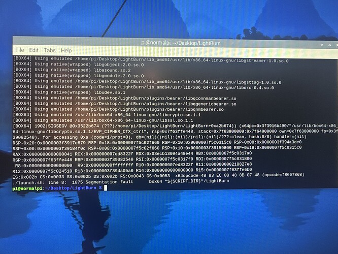

Ok. So managed to get it to run. Then after trying to update. It now just opens for only a few seconds and closes again. Any ideas ?
Afraid there’s not much I can help with. If you look some of the more recent posts you can see that the latest versions of LightBurn with recent RPi OS updates coupled with Ubuntu updates where necessary simply wasn’t working. I haven’t investigated beyond that.
What did this entail? Are you saying it was working prior to that? If so, can you revert to previous state?
Basically I checked for updates once it was open. Sadly I had the same issue first time round too when I didn’t try any updates.
First run seems to go ok. Then doesn’t want to run again if I close it at all.
Any ideas why this could be.
That seems odd.
Try running it back to back where it works in the first run and fails in the second. Capture the complete terminal output into a text file and upload here please.

Error!
In the terminal output, I got this error complaining about a missing library:
[BOX64] Error loading needed lib libcom_err.so.2
[BOX64] Using emulated /home/pi/LightBurn/lib/libkrb5support.so.0
[BOX64] Error loading one of needed lib
[BOX64] Error initializing needed lib libgssapi_krb5.so.2
[BOX64] Error initializing needed lib libQt53DExtras.so.5
Additional commands (the fix):
This will download the additional library; extract it into a temporary directory; copy that file into LightBurn’s lib folder (should already exist); delete the temporary files.
cd ~/LightBurn    # go to your LightBurn directory
wget http://security.debian.org/debian-security/pool/updates/main/e/e2fsprogs/libcom-err2_1.46.2-2+deb11u1_amd64.deb
mkdir -p tmp-deb && dpkg-deb -x libcom-err2_*_amd64.deb tmp-deb
cp tmp-deb/lib/x86_64-linux-gnu/libcom_err.so.2.1 lib/
rm -rf tmp-deb
rm libcom-err2_*_amd64.deb
If you’re still encountering an error, I’ll add more information here.
