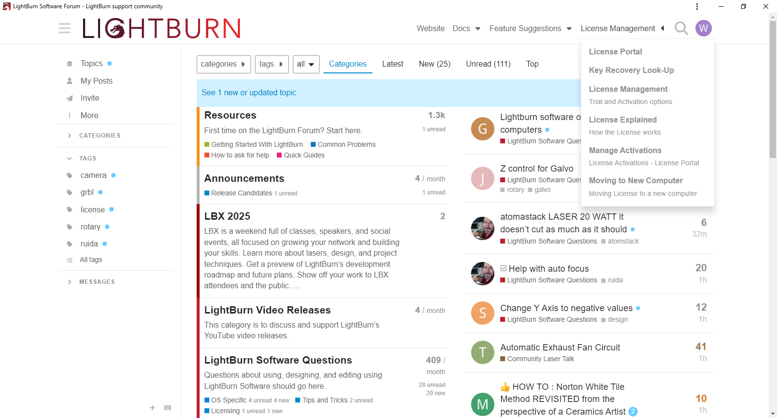

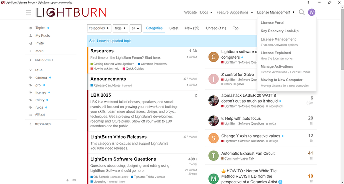

I was refering to the store page where the licenses are.
No fiddle needed. One key, up to 3 machines at the same time. In the old days, they called it “1 license, 3 seats”.
I have 3 machines activated and it was a no-brainer. If there was difficulty, it might have been due to different expectations of how it should work. I have been working with PC’s and software since 1974, and this system was very easy for an old man to use.
We already have a license system, what do you mean “Fiddle with license keys” ?
Are you using the License Portal to view your key ?
