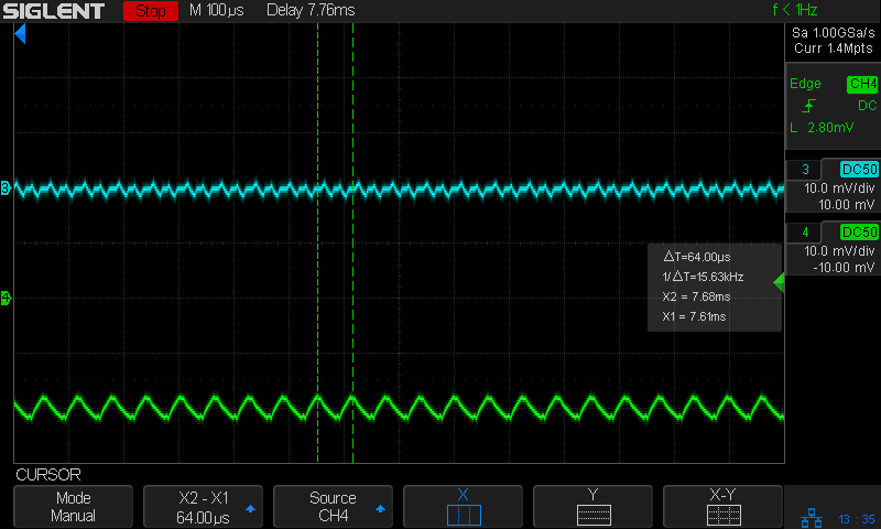

I read somewhere that stepper motors “humming” when current circulates in the coils, and that the sound comes from the motors..? The sound is just like a small computer fan spinning quietly.. The motors don’t get hot at all when the laser is at rest, but I guess they get hot during use anyway. It’s a bit worrying because I don’t know about these things. Hopefully someone here on the discussion board can give me the right information.?!? Thanks for the reply!
That’s exactly what’s happening. Stepper drivers regulate the current by chopping the supply, so the current varies at the chopping frequency. Folks with better ears than mine can hear the effect of the varying magnetic field on the motor’s iron armature.
The motors have two windings and their currents vary with the rotor position, so the sound changes depending on exactly where the rotor stops.
For example, these are the winding currents at standstill:
The switching ticks along at 16 kHz, which you (not I) can hear, along with its many subharmonics due to mechanical interactions.
Nothing to worry about here. Move along, move along … :grin:
