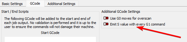

Small Favor Agoston
a) On your Console Window - Enable “Show all”
b) Make sure “laser on while framing is not on” do a frame
c) make sure Laser on while framing is ON - do a frame
d) go to laser tools > Device settings > Gcode
Enable Svalue with every G1 command
e) Frame again
Then see if you can scroll up on the console and send the full contents of console
Also on the last frame, do crossways stay on?

So, if “fire laser” is ticked, then the behavior is now as expected… Because it turns on your main engraving laser as you jog/frame… And the command used (M3) will disable the crosshairs in the firmware. Previously we were probably sending M4 which we know from this thread was not. I’ll check with the folks who implemented this previously what the expectation there is… But I suspect that yes, we do want to change it back to M4.
And the jogging bug is now fixed as well - should be all good for the version.

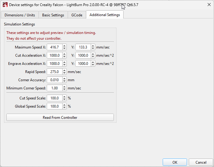

With the v1.7.08 I used to access the Read from Controller to get a better updated on processing time. It was located under Device Settings-Additional Settings. It is not there is v2.0.00-RC4. Is it gone now and if so, are the processing times more accurate?
I can confirm this for MacOS, I have already reported it for RC3, but the delay is still there in RC4.
When opening lbrn2 files the delay is over 15 sec., almost the same when closing, with or without files.
During normal work the system stops, depending on the time interval for autosave, for a few seconds (felt 3-4 sec.)
For the sake of accuracy, I just measured the time when opening a .lbrn2 file, it takes 17.43 seconds.
Hello Kelly,
Still, is there for GRBL? What is your controller/Laser?
This stops happening if Ruida is Online correct?
