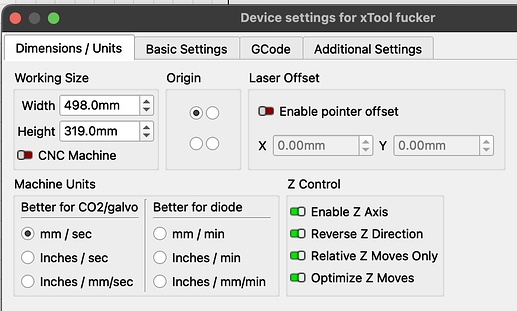

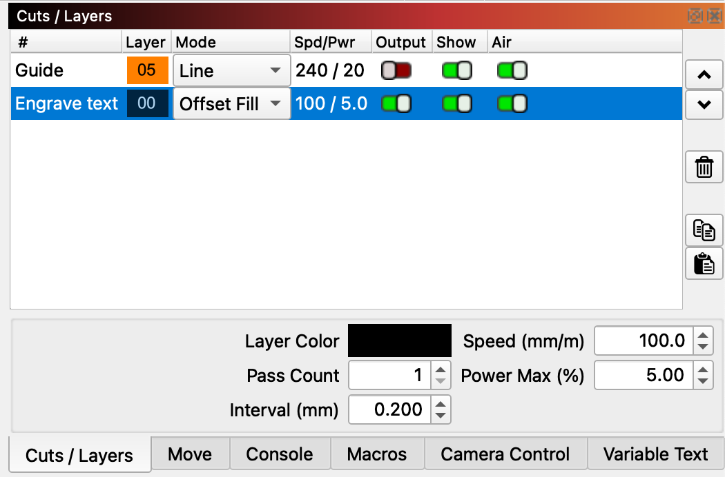

Edited to add: going into the laser settings panel and changing the units to anything else and then back to mm/sec fixes it.
Bug: Units being displayed/set incorrectly in Cuts/Layers panel
Units are set to mm/sec in the Settings panel, see screenshot, and although the VALUES are correct in the Cuts/Layers panel, they have changed to mm/MIN.
The machine proceeds to engrave at 100mm per minute.
I don’t know if I’ve done something, not knowingly anyway.

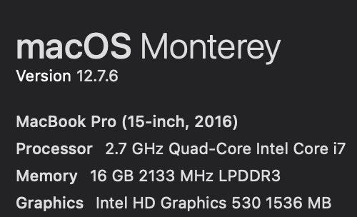

LB2 RC4, on a tired but functional MacBook Pro running Monterey (12.7.6, which is as high as it’ll go without hackery
), driving an xTool S1 40W.
Hi Bruce, I believe we already identified and corrected this issue for RC5. Thank you for reporting it in good detail!

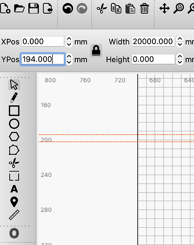

In 1.7.08 and 2.0RC4 if you create a guide line and then offset the line, you find that with Outward selected you actually get three lines instead of 2. If you select inward of course you get nothing and if you choose both, you get a line on either side just like with Outward.
Why I attempting todo this is there is NO way other than this to create a guide line offset from another. This helps when creating artwork so you know where things line up. It would be swell indeed if we could select a guild line, right click and have the option to create a guide line X/-X distance from it. Even on an angle as well. Just a thought.
Create your guide line, duplicate it and use the positioning tools with math to make it move the distance you want. In this case I made the guideline move up 8mm.

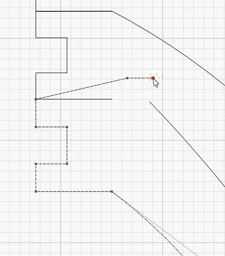

i tried to make a video with ashampoo snap 16 … the file is too big to send via e-mail … here is a screenshot of the last action
i clicked on the node and pressed “D” to delete it and than lightburn crashed.
hope that helps. … meanwhile i will try to take another video …
video and LightBurn_Crash_Log sent …
thank you very much for your effort.
In the meantime, I have recreated the file from the beginning … everything is fine now … but I thought it might be interesting for you to find the error ![]()
