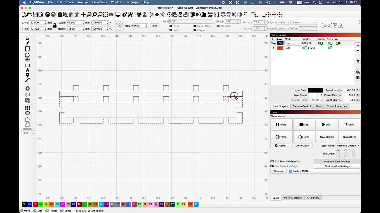

Small anomaly when using scissors tool in LB 2.0.01
I think we had this problem before but got it fixed, now we have it back in 2.0.01 (1.7.8? - not tested)
Hi Bernd,
Thank you for reporting this
Could you possibly share that LBRN file so we could give a try to replicate that?
Sissor-LB.lbrn2 (11.3 KB)
:+1:
