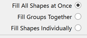

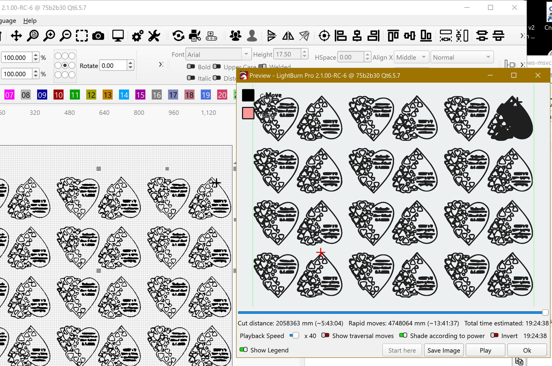

Messing with this file after a quick Sketch Trace.
If I select Fill All the Preview is ok.
 ![image](https://forum.lightburnsoftware.com/uploads/default/original/3X/3/a/3aa9560a486b12103db5a1fd0f3111fa9ff7469d.png)
 ![Fill_all](https://forum.lightburnsoftware.com/uploads/default/original/3X/f/8/f83f7750eb5df025d87088c3128db4ff721040c8.jpeg)
If I select the other options the Preview has a bug.
 ![fill_groups](https://forum.lightburnsoftware.com/uploads/default/original/3X/5/0/50c9dab0c602032e19acc86c61d64a0b65861311.jpeg)
 ![fill_indi](https://forum.lightburnsoftware.com/uploads/default/original/3X/b/7/b7553dc2f10e5d5a4a0de295238fdef9c84286d0.jpeg)
[Preview\_bug.lbrn2](https://forum.lightburnsoftware.com/uploads/short-url/s0oqeSH2VQIRiTt0wRcRgFGeIPO.lbrn2) (753.5 KB)

Just for grins I opened this in 1.7.0.8. Acts the same. I moved a line here and it works as advertised.
 ![image](https://forum.lightburnsoftware.com/uploads/default/original/3X/1/f/1f49e2d886be2bead4373940d9452bcc35aeb187.png)
