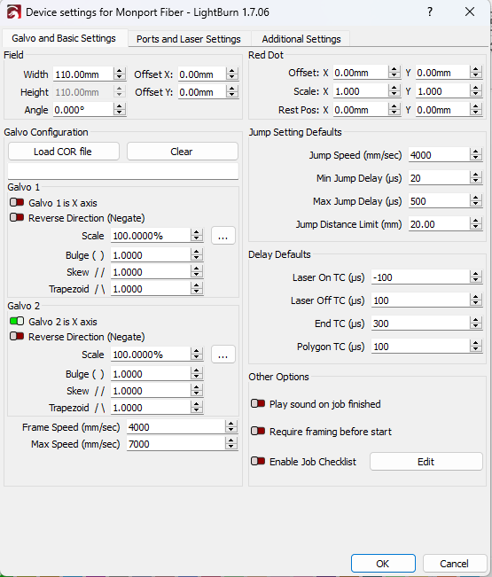

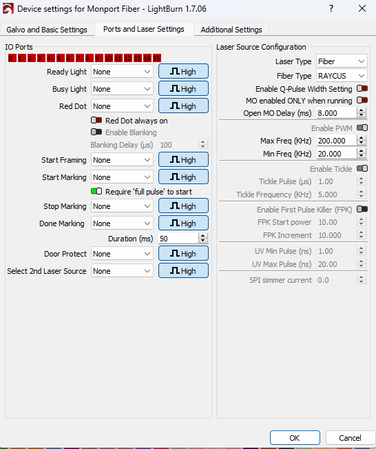

I recently purchased a Monport GM50 galvo fiber laser. I don’t know what fiber type I have either. It shows in the owner’s manual IPG\_YLP but not sure that is correct either. I purchased Lightburn version 1.7.06. I cannot get my laser to frame. I have watched several videos and searched this forum and cannot find any help. I have screen shot all the pages like everyone said to do. My laser works. I can engrave a plastic business card but without framing it’s hit or miss how it will turn out.

besides the options for the red dot seem to be off / not set?

Thank you. I read through some of the links you sent and it is now working. I just had to change the value under IO for red dot from none to 0 and it started working.
