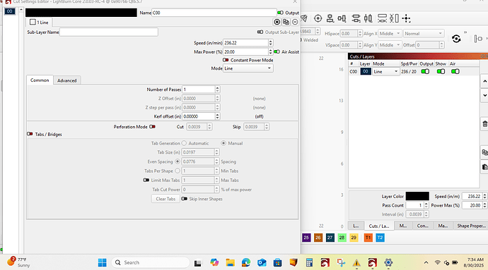

Installed and still having same issue. Is there anything else I can try?

If you tried adjusting the font size in settings\>display and it’s still too tall you can use the enter key to confirm changes and escape key to cancel.
