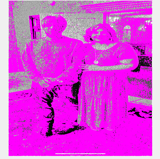

I have a Longer Ray5 5w, currently Im having HUGE problems with my system freezing and crashing once I try and trace my image. When I load my image ill adjust it to liking, then save as a bitmap then when I load it back in and then try to trace my system freezes and crashes been going on for around 3 days. This is the only way I have found to get true and clear photos engraved with this machine. Any help would be appreciated more than you know.

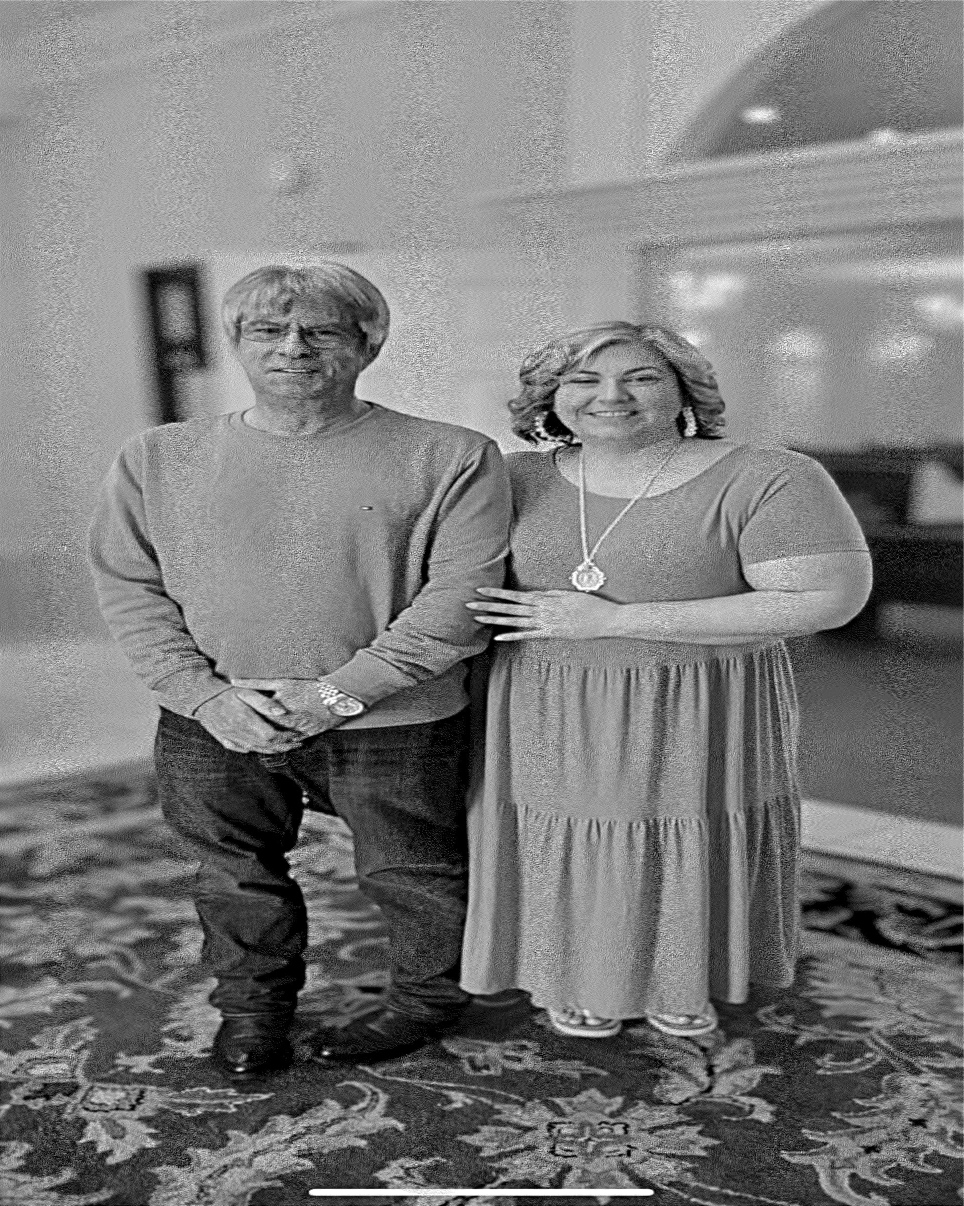

Heres the photo that it keeps freezing on.
Ok, can you post the bitmap file that you have saved?

I downloaded the bitmap and quick poke at tracing,
Yes as you can see its traced really good but when I go to load it into light burn it crashes. I’ll download your photo and see if it works with that. If so, was there any program other than lightburn you used?

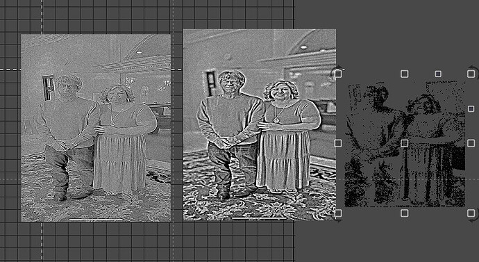

I am not having a lot of success with the photo and the adjustment sliders… Photo engraving is not my specialty, but I will try.

If you want the picture just use the photo mode play with the contrast and burn it. You could remove the background to get more attention to the person. I do not think you will have any advantage tracing this photo.
+1 I agree. The photo is not suitable for tracing, at least to my level of ability. A direct engraved photo as suggested by @Enno may be your only chance. It does not have to be in Grayscale, please also look at Stuki for the dithering logic. Photos are my kryptonite in LB :frowning:
WHY your machine chokes on the Trace command, I cannot say. I can. my results are horrible, but not machine crashing horrible.

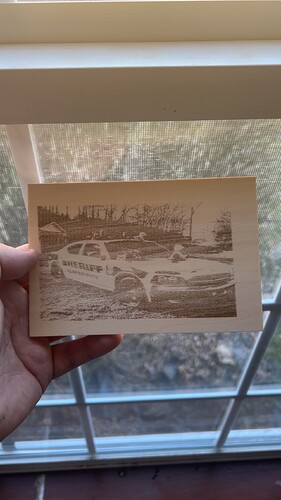

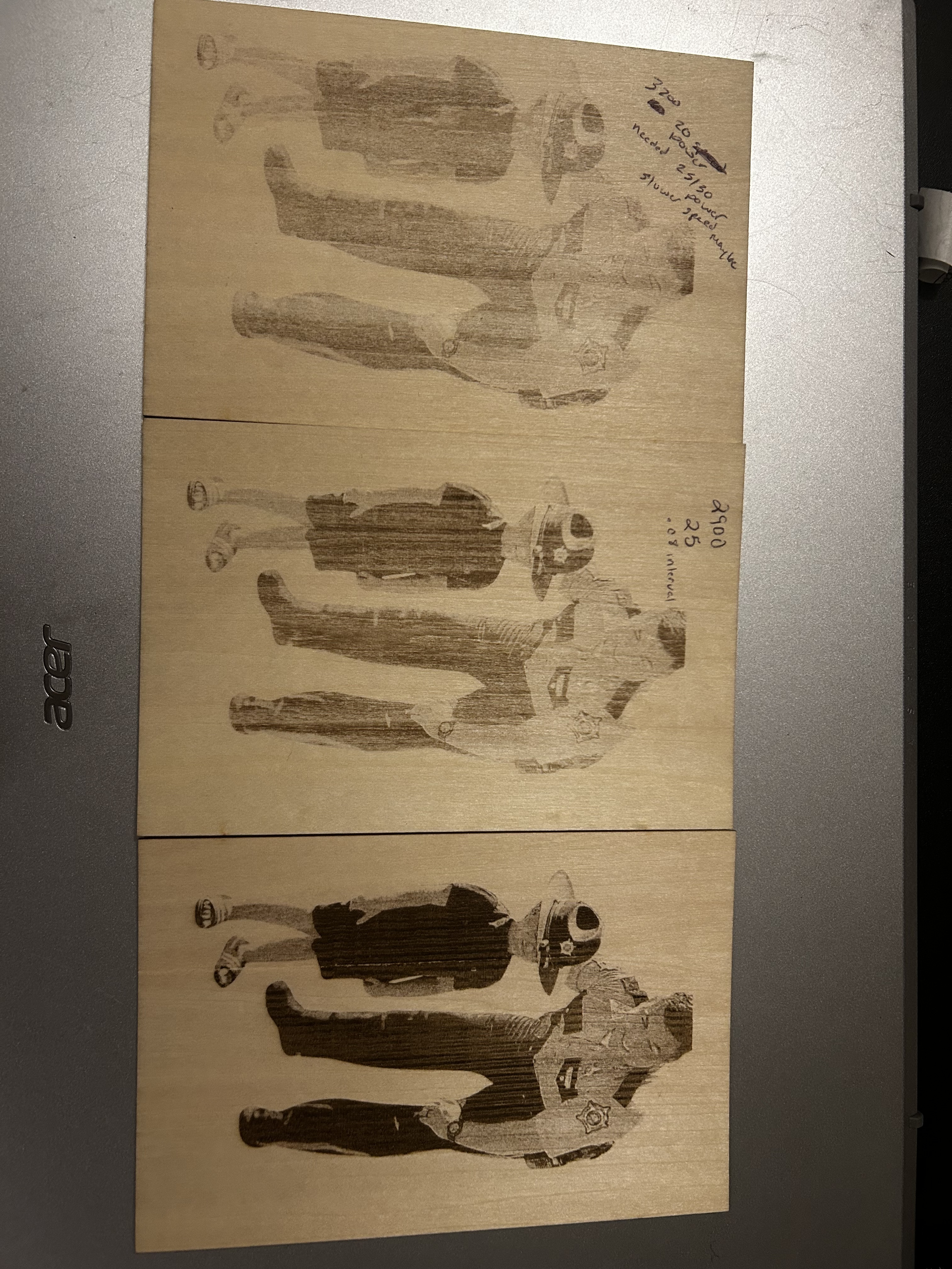

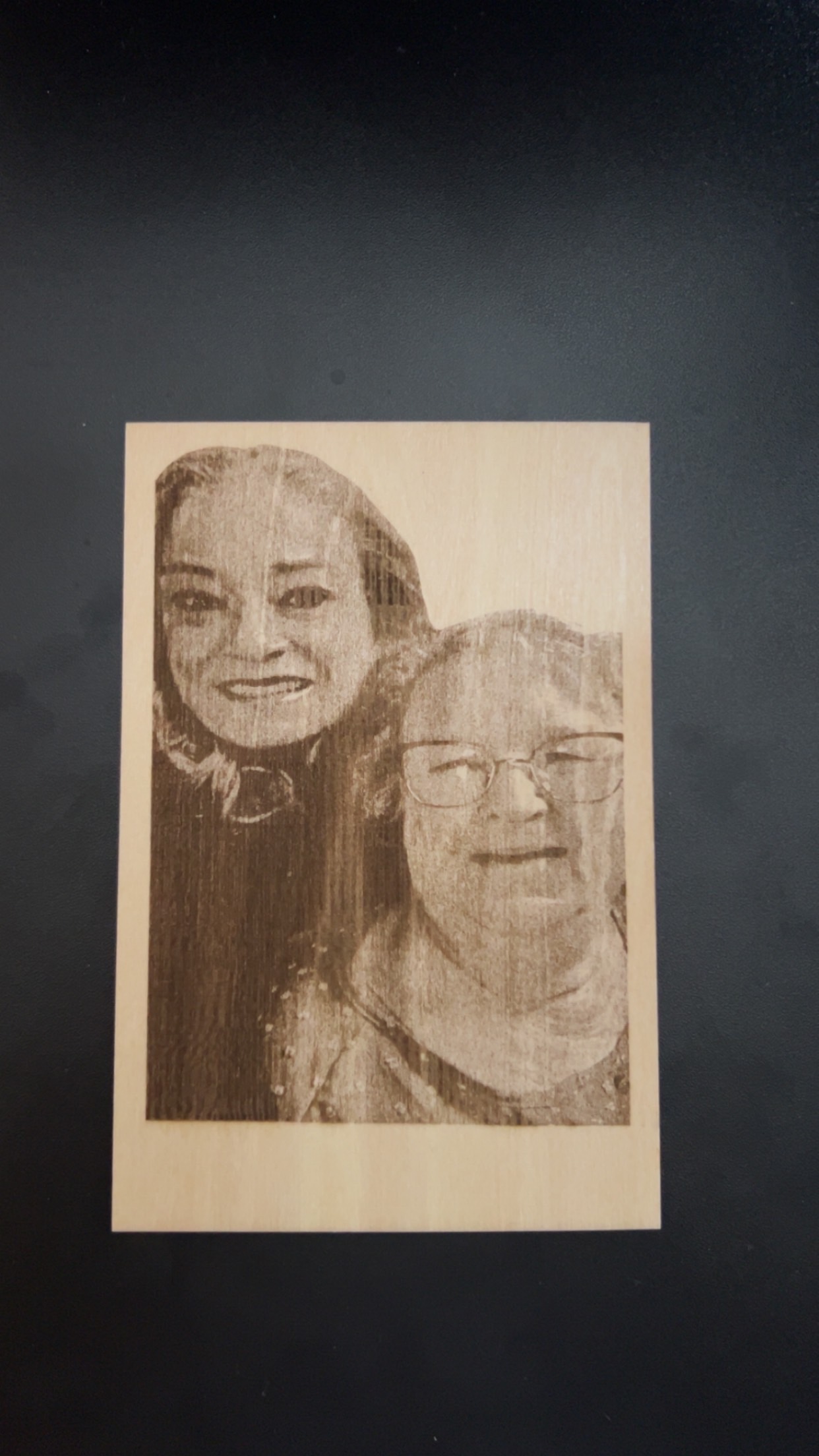

Right I understand. I just for some reason haven’t had a problem with the first maybe 5-6 photos I have done. Added is some photos of done from work and a picture for someone to get the right settings. But I appreciate it.
