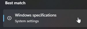

Do you have a Windows N Edition?
If you are running a Windows N edition, please install the ‘Media Feature Pack’
To check your edition click here
Use the Search bar to find and open ‘Windows Specifications’ , where your edition will be displayed;
Follow these instructions if needed:
