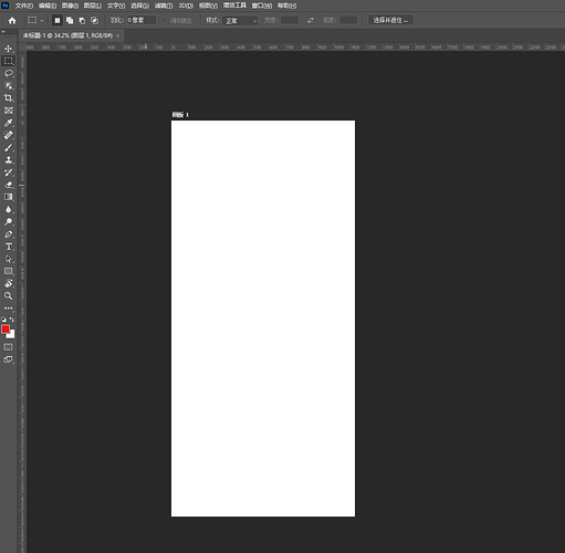

我希望lightburn能越来越好,个人小建议。
今天工作时发现的问题,这是一个很实用的功能。就是在新建工作任务的时候,能不能像photoshop那样,新建工作页面不要和当前的工作页面有任务冲突。
目前,我实际操作,新建任务,它就会要求页面保存或放弃当前的任务操作。
能不能像ps那样,新建工作页面而不影响我当前的工作任务。附图片
In development plans since 2018
Try creating a NEW window instead of a new file
When you click on New Window, it may ask if you want to do something with the current file. I usually say No or Discard. You can open as many new windows (instances of Lightburn) as your system will allow. I often so this to copy something from a prior work, then close it. The original work is still there waiting for my return.
Be aware you can only control the laser with the first instance of Lightburn.
