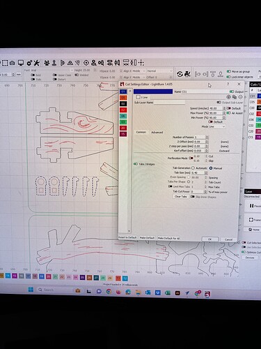

Hello, I have been using Lightburne for over a year now and often use tabs which I manually place in the colour layer section For some reason I cannot manually place tabs. I can automatically place tabs, but they will not. Let me move them to make them manual. If I select manual, all my tabs disappear.
I have used this function a lot, and for some reason it’s not working any more. Could this possibly be an update? I have tried multiple computers and the same thing is happening.
They still show up in the older files that I made, but will not let me make new additions.

No, it’s definitely in line mode. I’ve cut thousands of these things and it will let me put tabs on it even now, but only automatically not manual. If I go into manual on the main screen, it will let me put them in but doesn’t transfer over when I go to cut

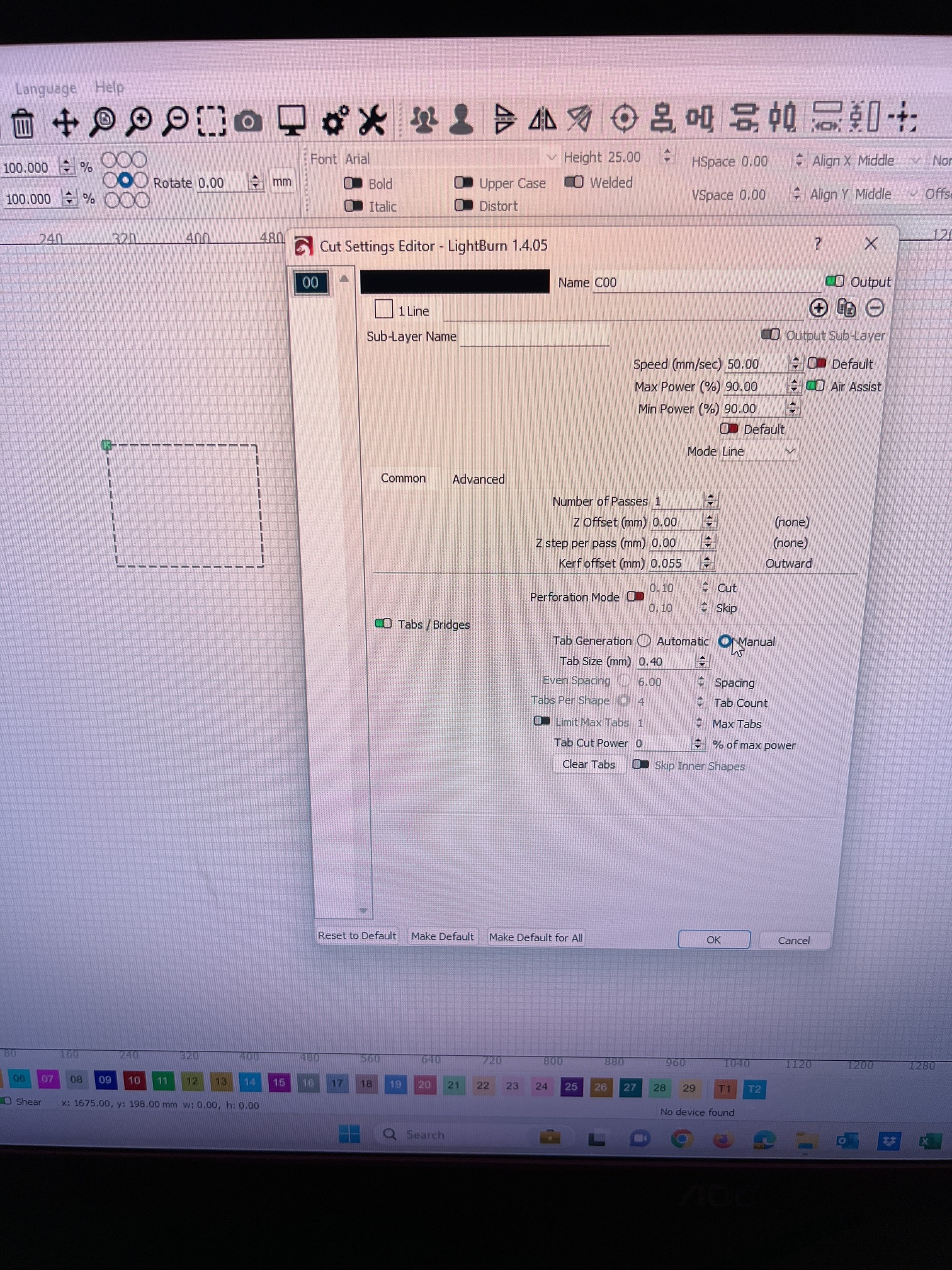

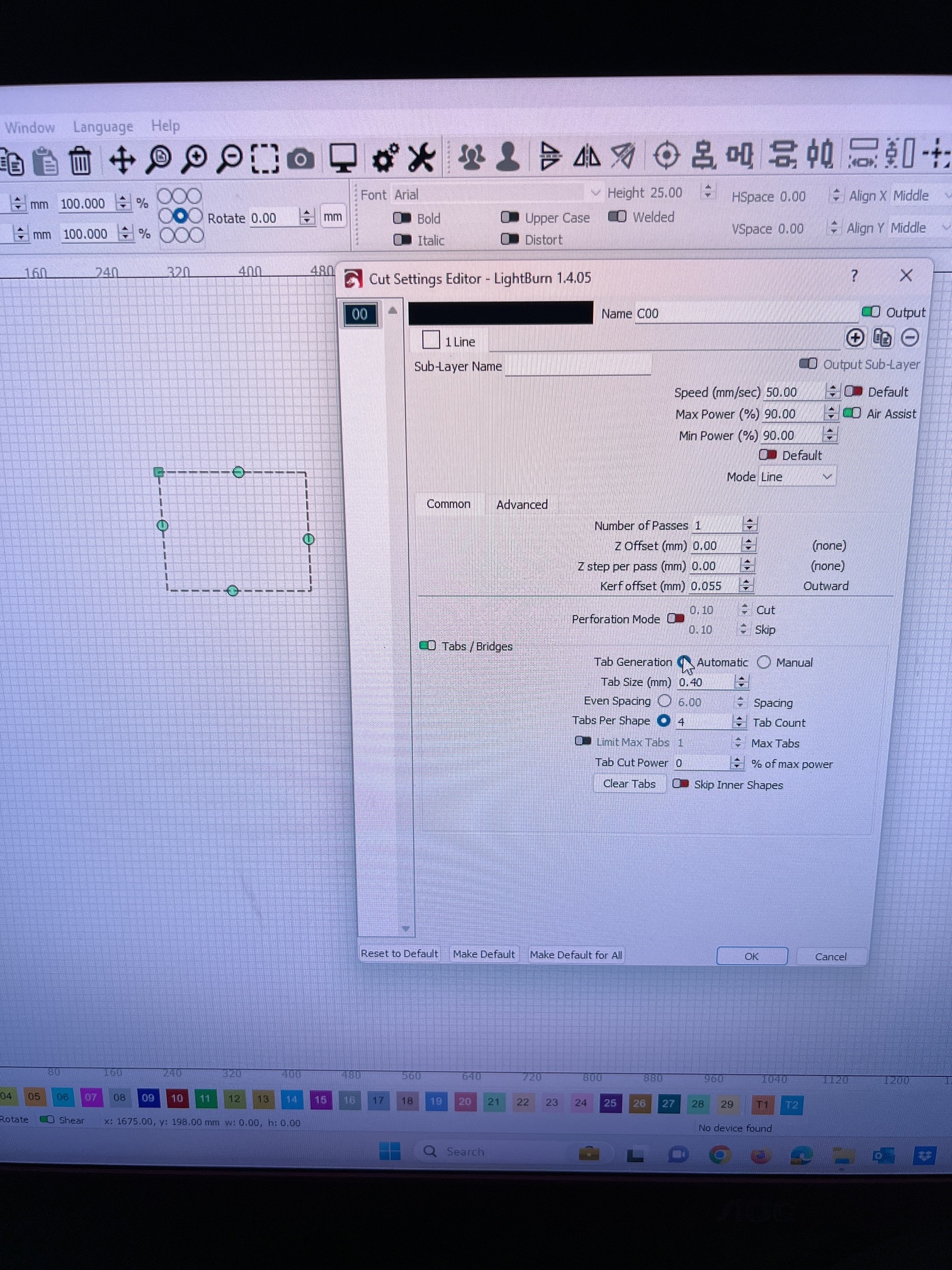

As you can see there is tabs when it’s on automatic, but when I flick to manual, they go missing
As far as i can understand, this is expected behaviour
The moment you change to MANUAL mode, the automatic tabs are cleared. Then you must use the TAB tool and click the tabs you want in place.

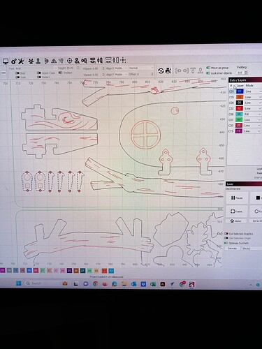

As you can see when I haven’t got the screen up, it shows the tabs I manually put in when I bring the screen up. It’s removed them. Normally it shows them

For me it only shows me tabs if
a) i have layer open (Cut Settings Editor)
b) i have the shape selected and i am in tab tool mode
