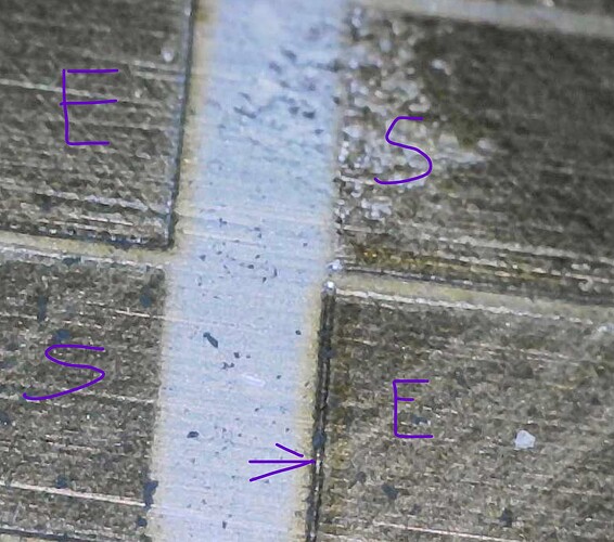

Line added to the end of each slice (Dialing in X table)

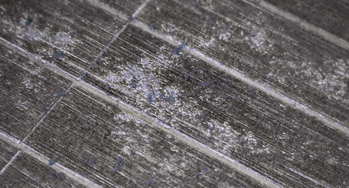

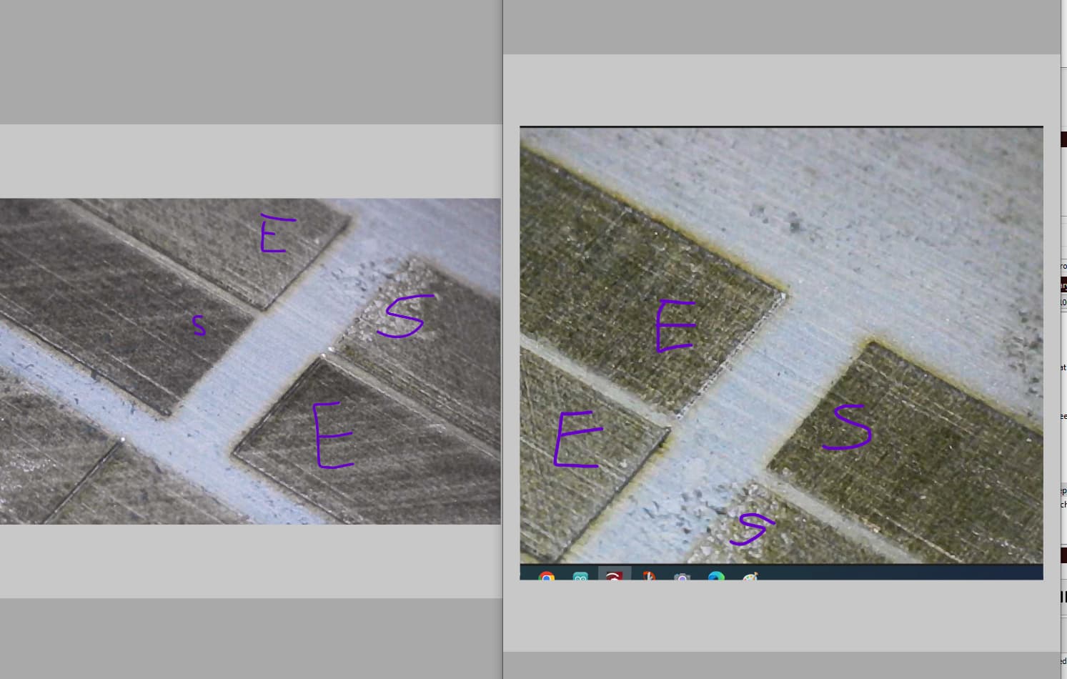

Really trying to fine tune the X table, getting a tiny line at the splits, at the end of each split, whether running horizontal, vertical, or diagonal, the end of the split burns deeper then the start. If it was just horizontal I would think end TC, but that wouldn’t affect the entire line running vertical. Stretched it out to separate the start and end and really get a good look.
Overlap: tried zero to a couple line widths. Made it worse.
It just burns extra deep at the end of each slice, not end of each line.

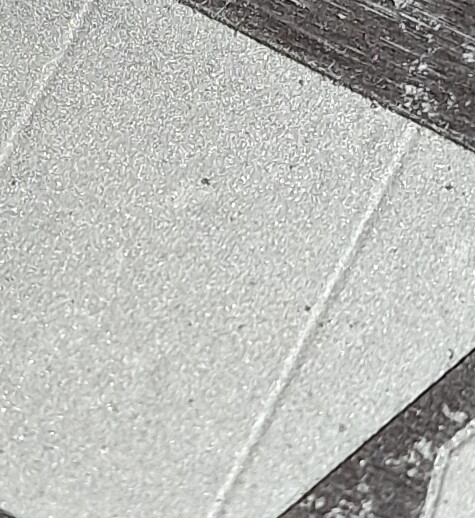

After media blast, clearly burning in/ deeper.
Best I could get, running 0 deg 0 overlap.
TIA
One more photo, it is actually burning a line at the end of each slice. This blowup shows pretty clear a vertical line was added at the end of the slice.
How did you set this up.. is everything in bi-directional mode enabled?
Are you sure your start delay isn’t too low… If it’s always where the line starts, it may be related. Are you sure it’s occurring where it ends?
Sometimes the issue is more difficult if we can’t isolate the issue using bi-directional on or off to identify it.
I usually am the one with the answers when it comes to the rotary axis, I have ran through timing and delay, stretched and shrunk the circumference. added and subtracted the steps. Tried adding a little overlap. What I am coming up with the laser isn’t adding a line, but it sure is reproducing the effect of running an extra line.
So this is where I’m at, my steps/ diameter are fine. 192000 steps / 600mm circumference, microstep driver set at 6400. Cross direction is real sensitive to circumference divided by steps, just like a ring or a cup. I can nail that. But parallel where the ends of the scans line up I have to override the timing by increasing the start TC, like change from -75 to + 125, and also increasing the end TC from like 0 to +25. Bi directional works a little better kind of interlaces the ends. For 30 degree and 45 degree hatch I think I need a slightly different set of TC’s. Haven’t gotten those dialed in yet. For deep engraving really nice to run multiple directions. Also haven’t messed with the delay, might slow that down for some testing.

So to do a rotating scan/ deep engrave and not end up with the overlapping line effect, probably need 3 different sublayers, one for zero, one for 45, and one for 90. each with different TC overrides. No cross hatch on the 0 or 90. Bi OK
