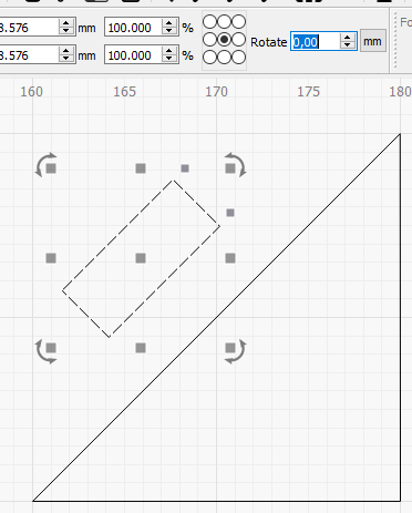

Line alignment of two objects
How do you align these objects so that they are both in alignment on the same plane?

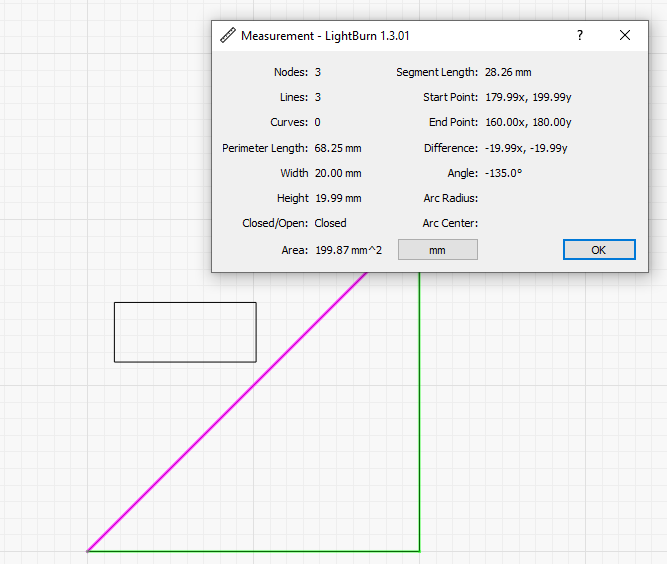

Interesting question.
There is at least one way to do it: I would use the measure tool.
By hovering the slant, I have its angle.
Then I can select the rectangle, type the angle in the rotation field, and I am done:
Two-point rotate and scale is ideal for this. Take a look at the docs:
Two-Point Rotate - LightBurn Software Documentation
That works fantastic so simple thank you and a big thumbs up. Thank you Jim
