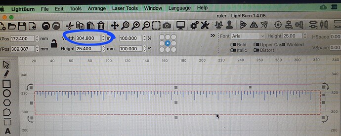

UPDATE: I deleted the line and added it again, it now shows the same size as the box. Don’t know what happened, but I can now proceed. Thanks for the quick response!

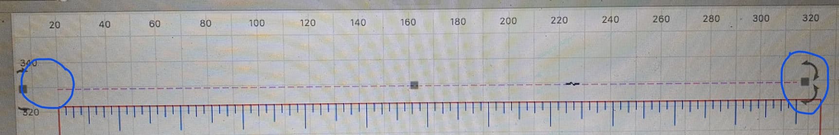

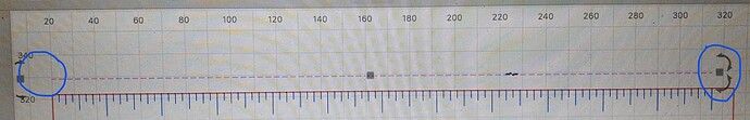

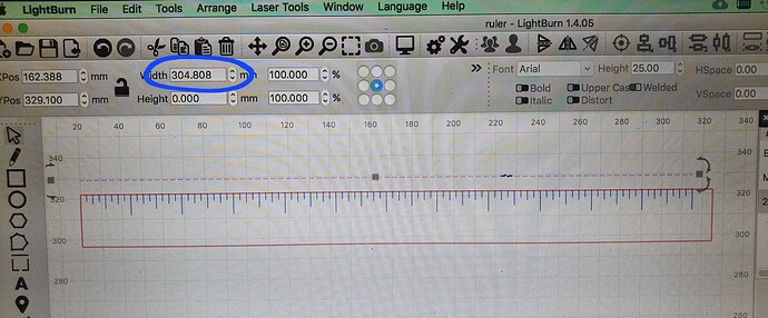

Trying to make a ruler. The rectangle says it’s 304.8 mm (12 inches) wide and the line is 304.8 mm long, yet they are obviously different lengths on the screen.
Help or clarification from someone?
Your ‘line’ looks like it’s got an extra bit of geometry at the left-hand end. Note the relative distances of the selection handles from the line itself:
