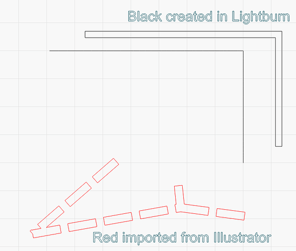

Lines to thick dotted lines
I would convert lines to filled dotted boxes. I could dotted lines using the performation mode and It is easy to convert to shape using offset, but in this way I lost the dotted
is there a way to do it? maybe any easy one :slight_smile:

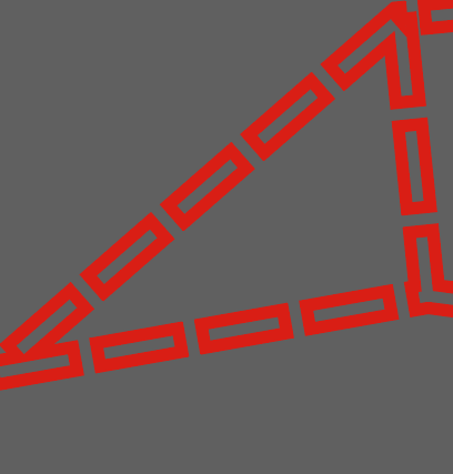

You might try “copy along path” using the solid line as the path (on a tool layer) and filled rectangles of the desired size and spacing. Depending on the rectangle length and radius of any path bends, this may produce some undesirable angles, but I can’t think of a better way that wouldn’t require a lot of work. Maybe somebody else can come up with something better.

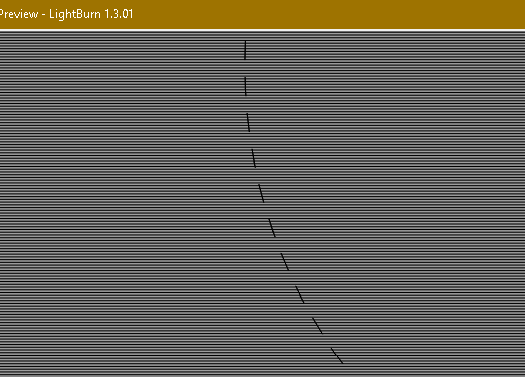

Do you need to see the dotted line or do you just need it cut off?
If you zoom in on the preview, the dot is still there.

I need to cut the boxes derived from the lines, like the image
If you zoom in on the preview, can you see the dotted line?
I don’t know if I understand you correctly, do you want to cut the red rectangles in perforation mode?
I see two parallel lines and not the boxes
And that parallel lines are the sides of the red color?

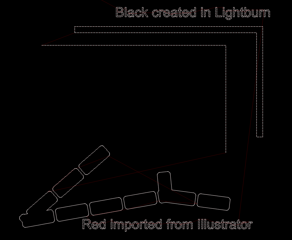

Also when converting to shape using offset you can keep the dotted line by unchecking the “delete original objects” option.
Here is an example from the project
test lines to oxes.lbrn2 (69,4 KB)
Sorry, I had to leave. Is this what you want?
test lines to oxes_1.lbrn2 (72.5 KB)

Are those red boxes the thick dotted lines you need?
If so, I think what Chris @cggorman said applies.
But it’s going to be a lot of work and I don’t see any other easy way of doing it.

It seems impossible to do in lightburn in an easy way. So I do it in other tool and import on it (it’s very easy to import file from Illustrator or Inkscape witch ctrl-c ctrl-v)
