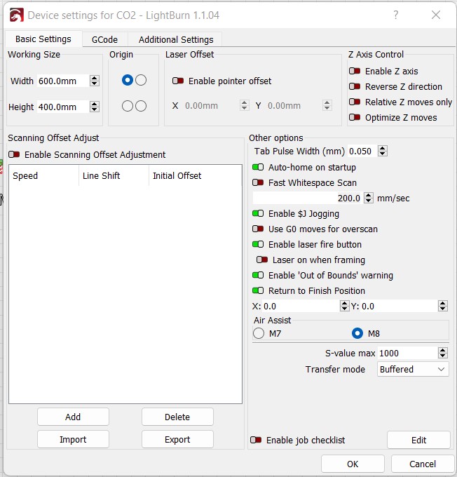

Hi everyone, when I cut a design on the CO2 laser (cutting inside shapes first) the laser does not switch off the power before moving to another shape - it just moves faster across the design but burns lines into my design. I am new to LightBurn please help is there a setting or what am I doing wrong. I am use to Inkscape and K40 whisperer - and now I upgraded the nano M2 to an Awesometech MG3 - its a whole new world with Lightburn. All my designs is SVG from Inkscape that I import into Lightburn.
Can you provide the following:
  1. Push Devices button in Laser window. Then select the name of your laser by clicking on it once and take a screenshot
  2. Screenshot of Edit->Device Settings
  3. Output of these commands in Console:
$I
laser settings file.txt (2.3 KB)
Screenshot 2022-05-28 002830
Can you send output of $$ in Console?
