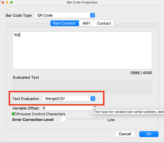

The thing that I do not understand from the above is how I can set the raw content of the QR code to be the variable text field, as lightburn does not seem to give the fields a name / identifier

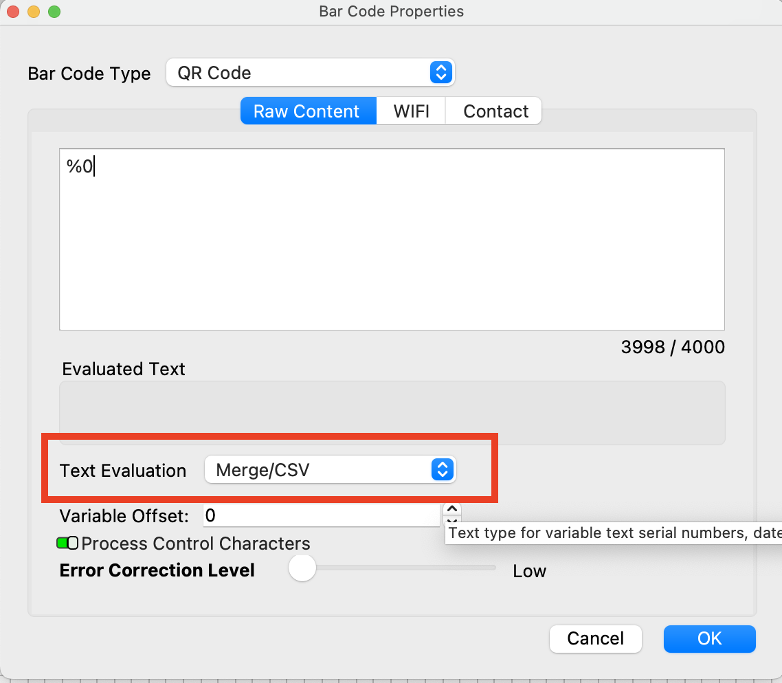

In the create QR Code dialog. Set your variable the nchoose Merge/CSV from the Drop down.

Correct, put the text in a CSV file and it can increment with each iteration. The “%0” is the variable placeholder. The same placeholder can be used in the QR Code and also etched onto the part. Read up on variable text here.

Indeed, this does not work. They way you would do that is that you would also fill that text object from the CSV file. So the text field also just contains %0 and both are set through the file.
You can’t read the text contents of a text object and use this as a variable for another object, I think.
I think you can have both:
  • A text block containing a field from the CSV file
  • A QR code generated from the same text field
Create the text block using Variable Text formatting, apply ordinary text formatting as needed, then position it where it’s needed.
Set up the QR code using the CSV selection @thelmuth showed with the same variable field as in the text block.
