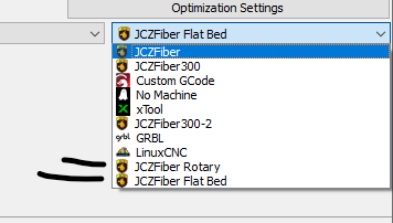

We have machine settings that work in ‘normal’ mode and another set of machine settings that work with a rotary. Is there a way to force a machine setting load via the command line or some other fashion so that the less educated user and start a batch file and get the correct setting for the configuration? Thanks

You can duplicate your laser, so easy to switch between Machine 1 rotary settings and machine 1 Bed Settings. Is that what you are after?
2.0 versions of lightburn allow you to choose a laser setup from the command line. This would allow you to setup a couple of shortcuts for regular and rotary use.
