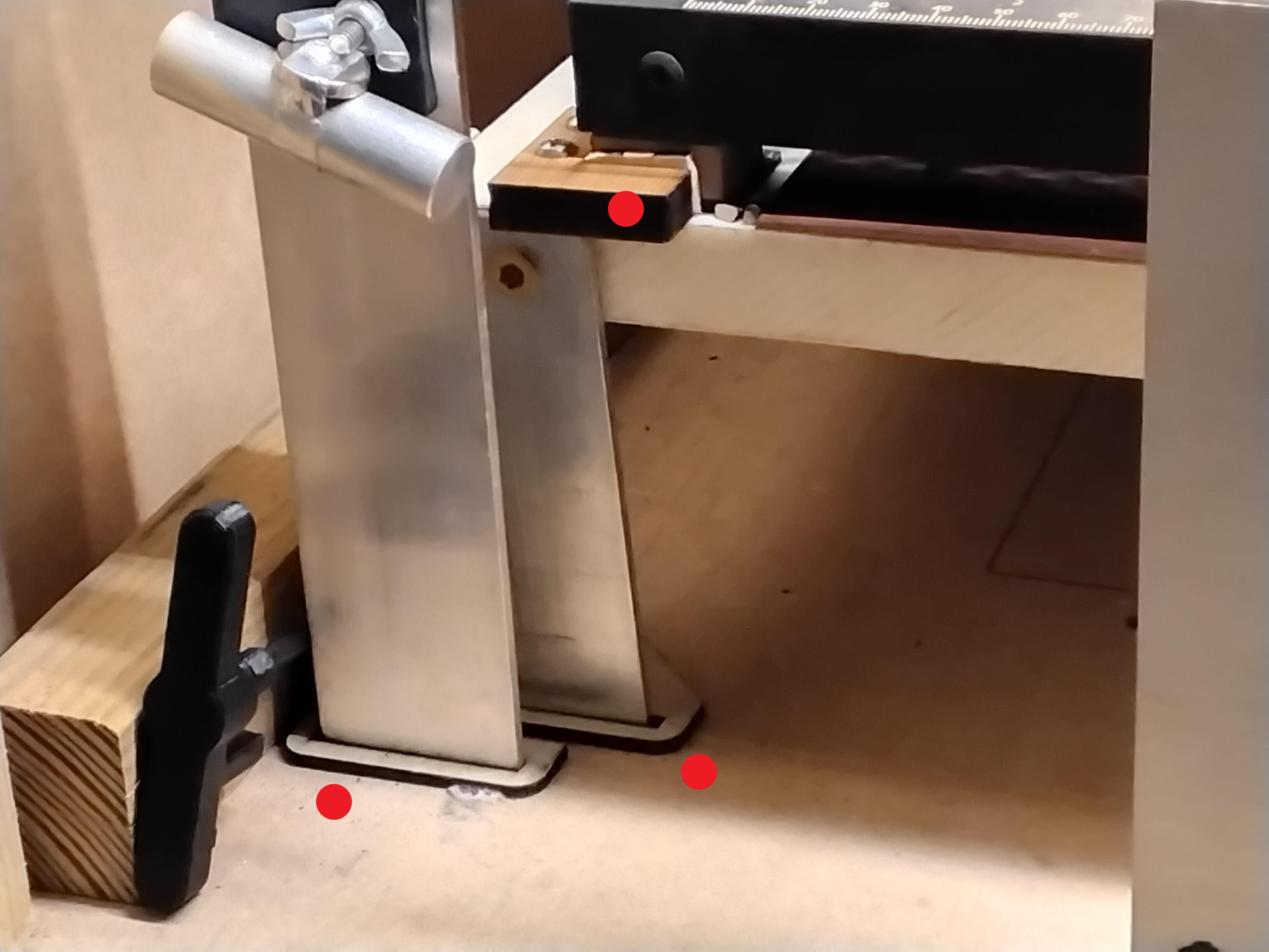

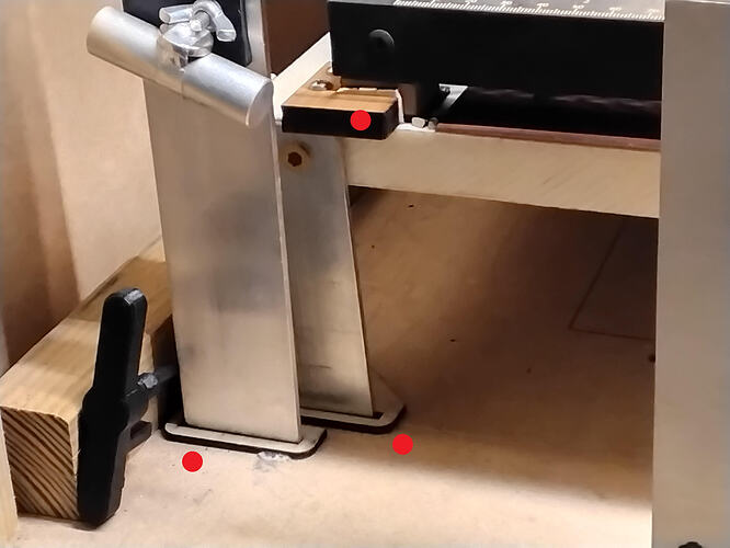

My S30 Pro has the feet captured by a cutout glued to the table. The honeycomb has the same positioning guide. I can remove either and place it back in the exact (relatively speaking) location. The honeycomb frame acts as my final locator for the templates. So everything goes in the same place. That leaves me as being the only variable.
If you are wondering why the stilts, it is raised so I can get the RA2 chuck rotary under it. The white base under the honeycomb has a big hole in it, which is normally covered with an aluminum plate.
