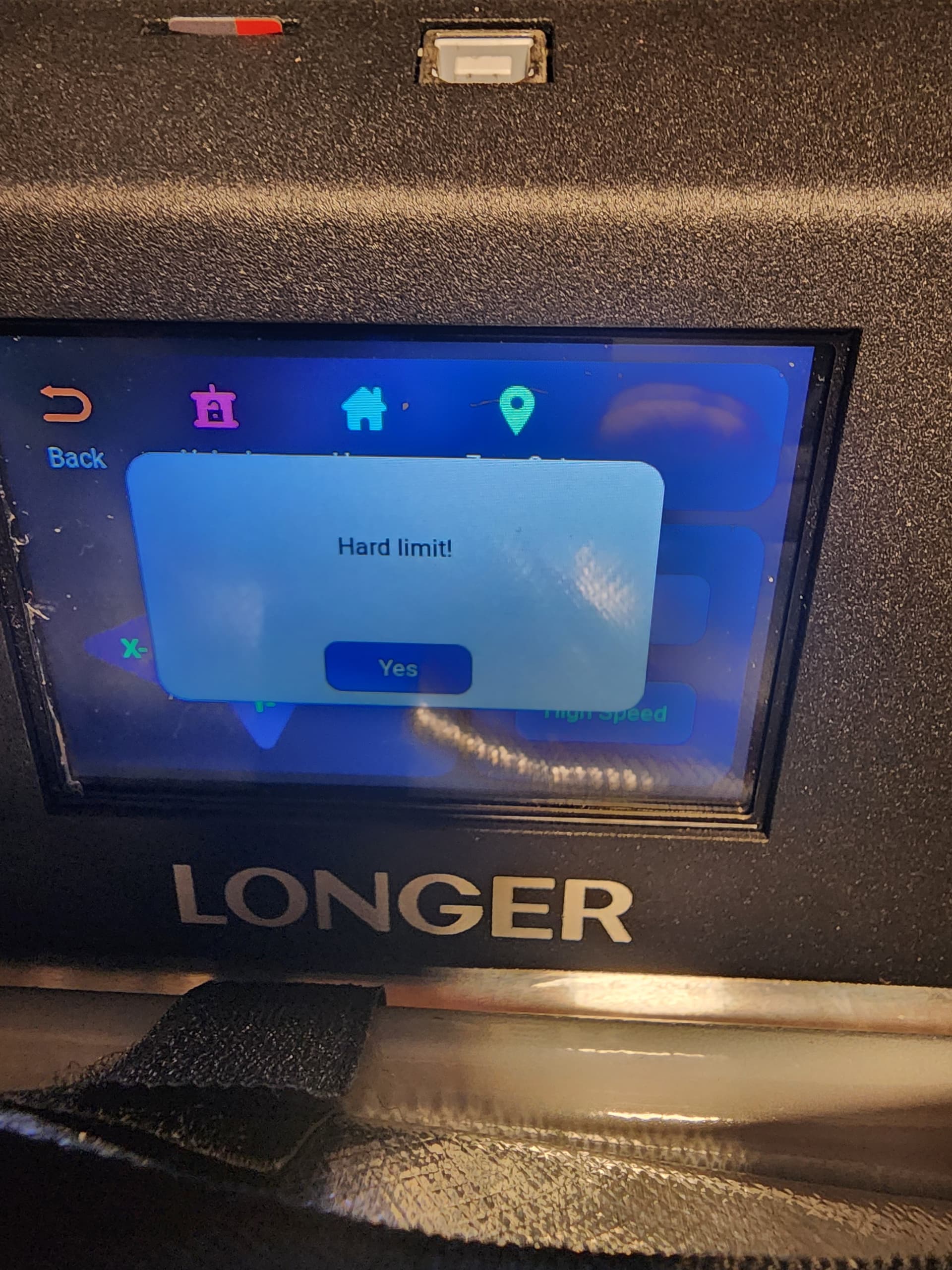

Lightburn will not recognize my laser because it’s stuck in Hard Limit! mode.
Hard limit! just keep popping up on the Longer screen and I can’t get past that.
Just got the laser and trying to set it up with no luck.

I can’t get past this warning.
Every time I press yes it just pops up again and again and again.

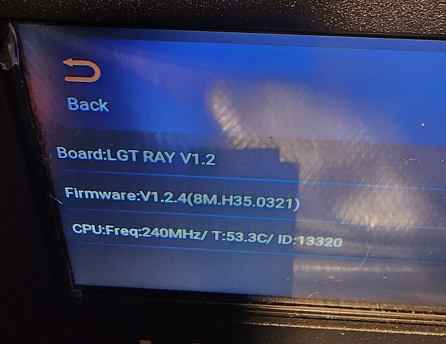

This video shows it requires a firmware update.
Got an idea :slight_smile:
Maybe the error you get is because you’ve already install this firmware! And as it doesn’t find actual limit switches, it bugs.

"The position of the laser module is assumed to be the home position by default when powered on. So the engraver will trigger the alarm 2 or hard limit error if the laser head is moved in the X or Y negative direction at this time. "
Yes the longer laser engraver does not come with limit switches. I’ve installed them and I’ve installed the latest firmware update.
I can get my laser to go into the Y coordinates but not x coordinates that’s when the error comes up every time.
The hard limit warning only comes on when I move it to the right the Y+ postion.
When I move it to the Y- position it just keeps crashing into the rail.

The upgraded firmware was installed before the limit switches but I had this problem already before I install the limit switches and with the new firmware already installed.

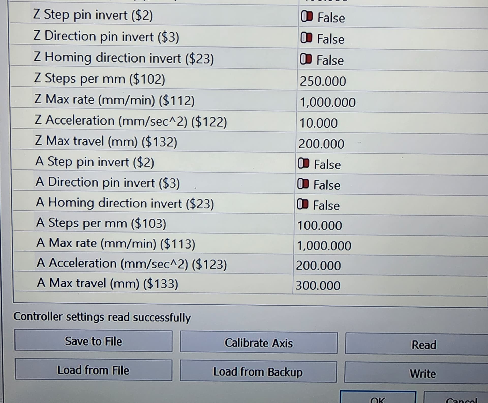

Do I have to put in specific settings in lightburn for my specific engraver?

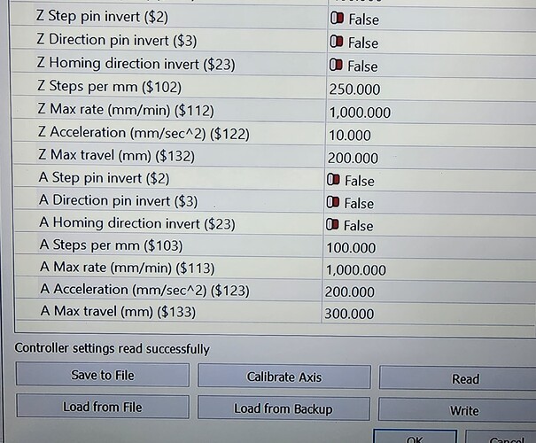

As a start ser X steps per mm ($100) to 80 and Hard limits ($21) to True.
