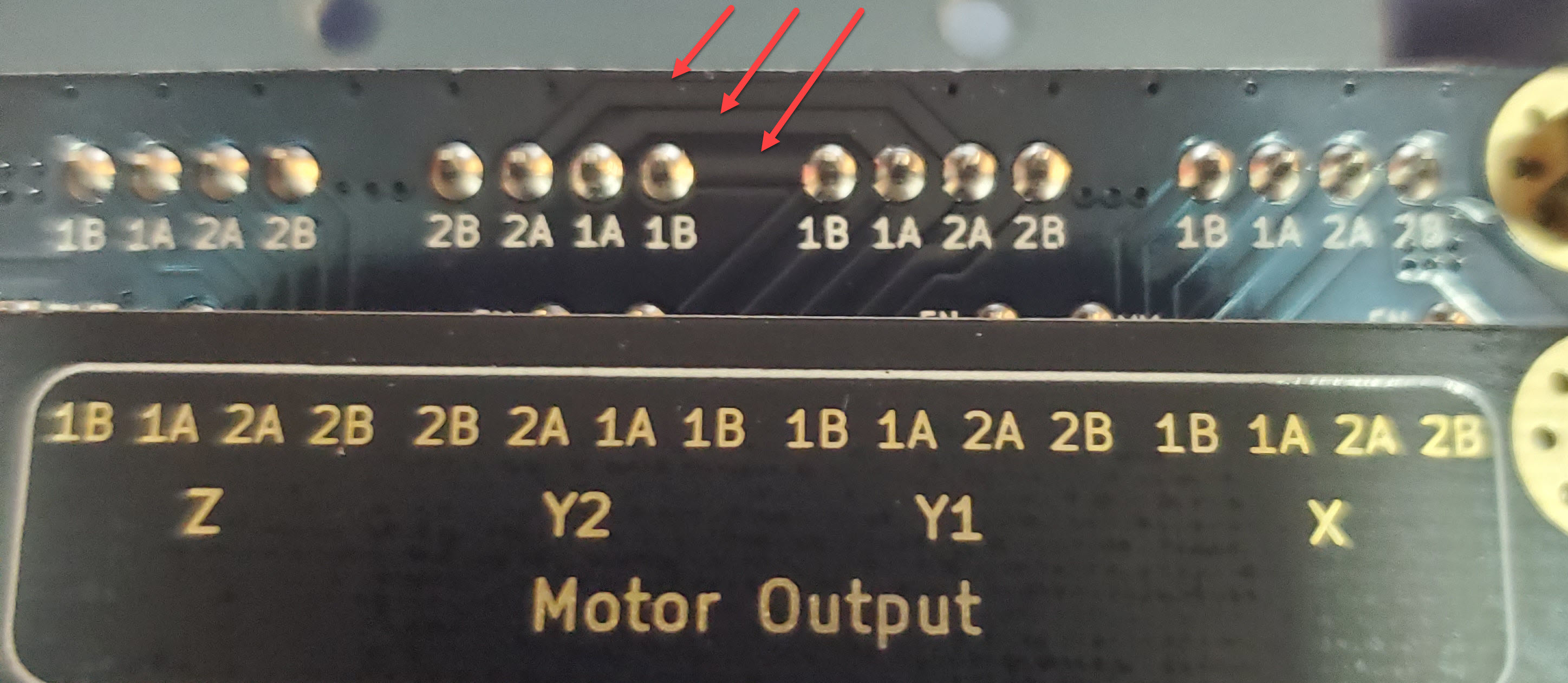

> [@vtskiman](#):
> Other people on other forums have replied that the Y1 and Y2 ports on a Grbl controller output exactly the same information data - so according to them, it shouldn’t matter which port the wire gets connected to.
I’ve seen separate stepper motor driver outputs on several boards labelled Y1 and Y2. These are usually set up and installed as mirrored images of each other. Occasionally these two motors are connected by a common shaft. This creates a dual-motor drive to move in the Y-direction and to push the heavier gantry around.
A motor can be reversed by reversing one pair of wires going to the motor. It can also be reversed in the software at two (maybe three) levels; (Build time / firmware default and Machine Settings). If the Manufacturer suggested that you use Y2 instead of Y1, the firmware, motors and cables are likely well known and standard enough to suggest that this reversal is needed.
I downloaded the [manual for the Limit switches](https://drive.google.com/file/d/1E55zHnM68xpyEuOj31or29TseB1UThhp/view?usp=sharing) to take a look.
The the Limit switch instructions show to use ‘Probe’ (Pr) for the Y axis limit switch. Probe is usually vertical (Z-Axis) and usually for 3D Printing (Or cnc… 🙂 )
I only see two stepper drivers on each board - something else is going on.
Below is a Pic. of an MKS DLC32 v 2.1.
Sorry for the glare on the ends but I wanted to catch a highlight on the top edge of the board where the circuit board traces are.
 ![Forum 104475 crop pic of MKS-DLC32 2.1 Y1 Y2 Detail](https://forum.lightburnsoftware.com/uploads/default/original/3X/b/c/bc37ca8998479784d540f427830cc6b7f557ff24.jpeg)
You can barely see through the solder mask, but there are three foils between Y1 and Y2. The pairs, 1B, 1A and 2A are connected, and they’re mirror images of each other - powered by the same driver chip.
When the stepper motor cable is moved from Y1 to Y2 the motor reverses. I imagine you’d see the same thing on the back of your board.
