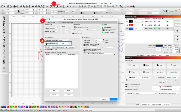

Hello all I hope you’re all doing well!
I’m having an issue with my omtech laser where any time I setup print and cut job, it resets the value of my air assist coming on in rdworks v8 from 6000ms to 0ms in rdworks v8 causing an alarm to come up on the controler saying air asst err and the job not starting.
For now I learned to deal with it by reading current value in rdworks right after i setup print and cut and rewriting it with 6000ms value.
Omtech support literally told me to learn to live with it as even though lightburn is advertised on their website, they advised me that there is nothing they can do about this.
Sooooo my question to you good people is do I have to use v8 to change this aux delay after value or is there a way to write a macro that would automatically check if that value is correct in lightburn itself after i press start button?
If not possible, can I make a popup reminder to appear after print and cut setup is complete?
Thanks all and have a great weekend!

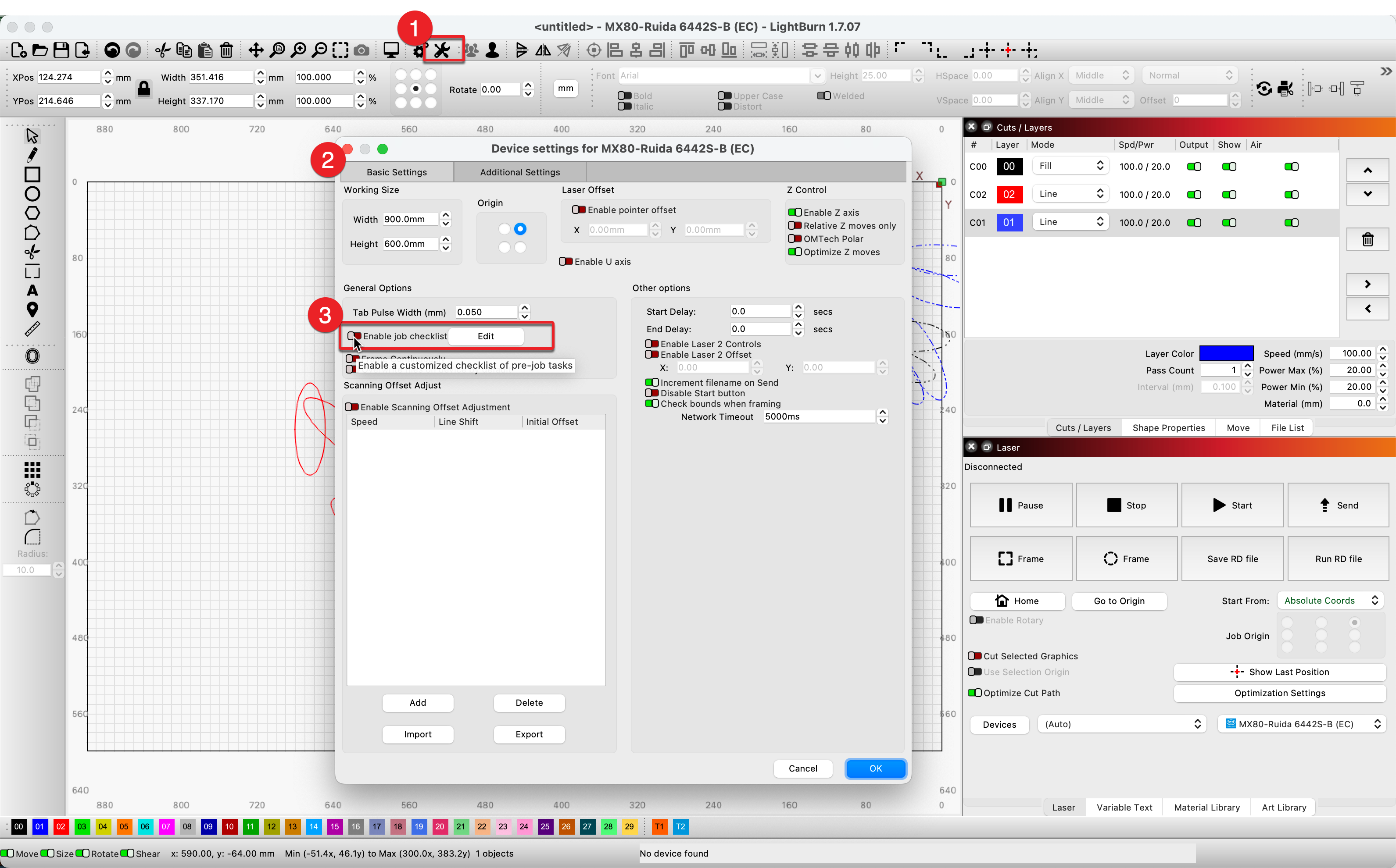

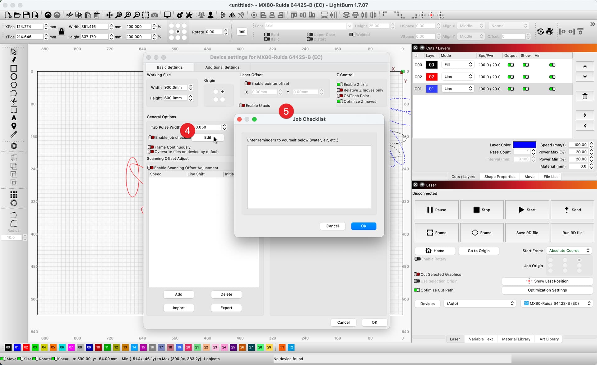

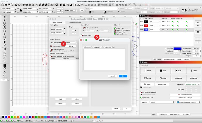

In device settings there is a “enable job checklist” that you can edit. This is in the LightBurn app not rdworks.

@AWA, to assist with Jeff’s reply,
> [@micrololin](#):
 ![image](https://forum.lightburnsoftware.com/uploads/default/original/3X/4/6/46281d4b82235a44ec39615401b75b734dba2dc4.png)
 ![image](https://forum.lightburnsoftware.com/uploads/default/original/3X/c/e/ce7214e9457cd182103da74244cb977e209940ee.jpeg)
> **[Device Settings - LightBurn Documentation](https://docs.lightburnsoftware.com/legacy/UI/DeviceSettings#enable-job-checklist)**
