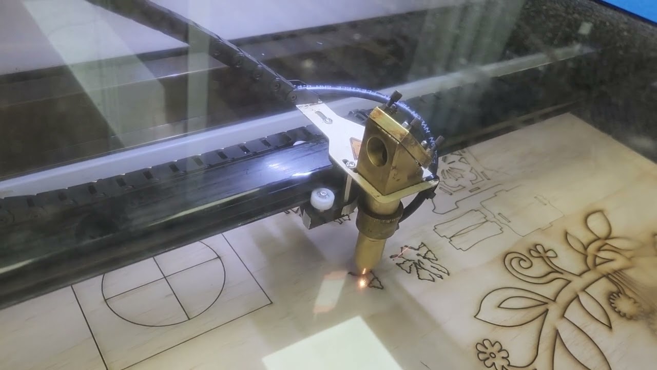

I’ve just spent a long time upgrading an old machine to a Ruida controller + lightburn. Almost everything now seems to be working, happy days.
One thing that is occurring which I cannot seem to resolve is that during complex jobs there often seems to come a point where the controller seems to lose position. A good example of this is a recent cut I did where in one layer in light burn I have a circle with leaves and vines and chains, etc some complex geometry. All gets cut quite well. In the next layer I have the outline of two birds - very simple curves. The laser has tracked the initial cut file very well, but when it gets to the birds, it completely loses its mind. The birds are cut over the top of the existing cut path of the complex geometry, and their outlines are wobbly, not connected at the end, and just generally a piece of spaghetti. Occasionally it will even forget to cut a line.
I’ve had the above scenario happen on a number of occasions with different files.
So things I’ve tried:
- Slowing down the machine maximum speed, ramping, and travel settings. I’m down to a max speed of 250mm/s at the moment, and ramping a little slower than that.
- Doing material tests and getting my overrun offsets etc correct with a micrometer. All the squares tend to come out well enough.
- Transferring the cut files to the ruins controller and hitting go. Still get screw ups late in the job.
- Running the cut files from the PC via light burn. Still get screw ups late in the job.
Months ago I posted about issues with bearing, motors, etc, and was given some good advice. Given this was an old Chinese laser that had quite poor maintenance I replaced all the bearings, one of the motors, the gantry carriage and runners, end stops, and whilst putting in the new computer etc replaced wiring etc. I’m absolutely confident in the mechanical and electrical quality of the upgrades at this point, though am not well versed in things like stepper motor controllers to know if I should be chasing a software setting, communications setting, or controller issue.

> [@anakaine](#):
> some ideas
This looks a lot like a communication problem destroying chunks of the job between the PC and the controller.
First of all, clear all the stored files from the Ruida controller’s flash memory, which you can do from LightBurn or the machine’s console. Ruida controller behave strangely when their memory fills up, so scrubbing it clean is always a good idea.
To diagnose the problem:
- Use LightBurn’s `Send` button to send the job to the Ruida controller and store it as a named file in the controller’s flash memory.
- Run that file from the laser’s front panel
If the stored file fails _the same way_ each time you run it, then the data was damaged along the way, the file contains damaged data, and the controller is correctly performing the damaged commands every time.
If the job fails _differently_ each time, then the problem is between the controller and the laser head, because the controller is running the same commands and producing different results.
To fix:
If the PC connects to the laser with a USB cable, switching to Ethernet will dramatically improve the results. USB was never intended for industrial applications and fails when confronted with typical machine noise.
If you’re _already_ using Ethernet, there may be an overlap between the controller’s fixed IP address and the router’s DHCP assignments. The router can assign the laser’s IP address to another device, so that network traffic intended for the laser collide with traffic for the other device. These collisions occur randomly and are uncontrollable.
You must either:
- Pick the controller’s IP address so it does not fall in the router’s DHCP range _or_
- Adjust the DHCP range to exclude the controller’s address
How you tweak the router depends on the router; we’ve seen some cable-company routers refusing to be tweaked. Knowing the DHCP address range will go a long way toward isolating the problem.
Obviously, if you’re switching from USB to Ethernet, you _must_ assign the controller’s IP address outside the DHCP range.
But, as the bluesman said: if it wasn’t for bad ideas, I wouldn’t have any ideas at all …
