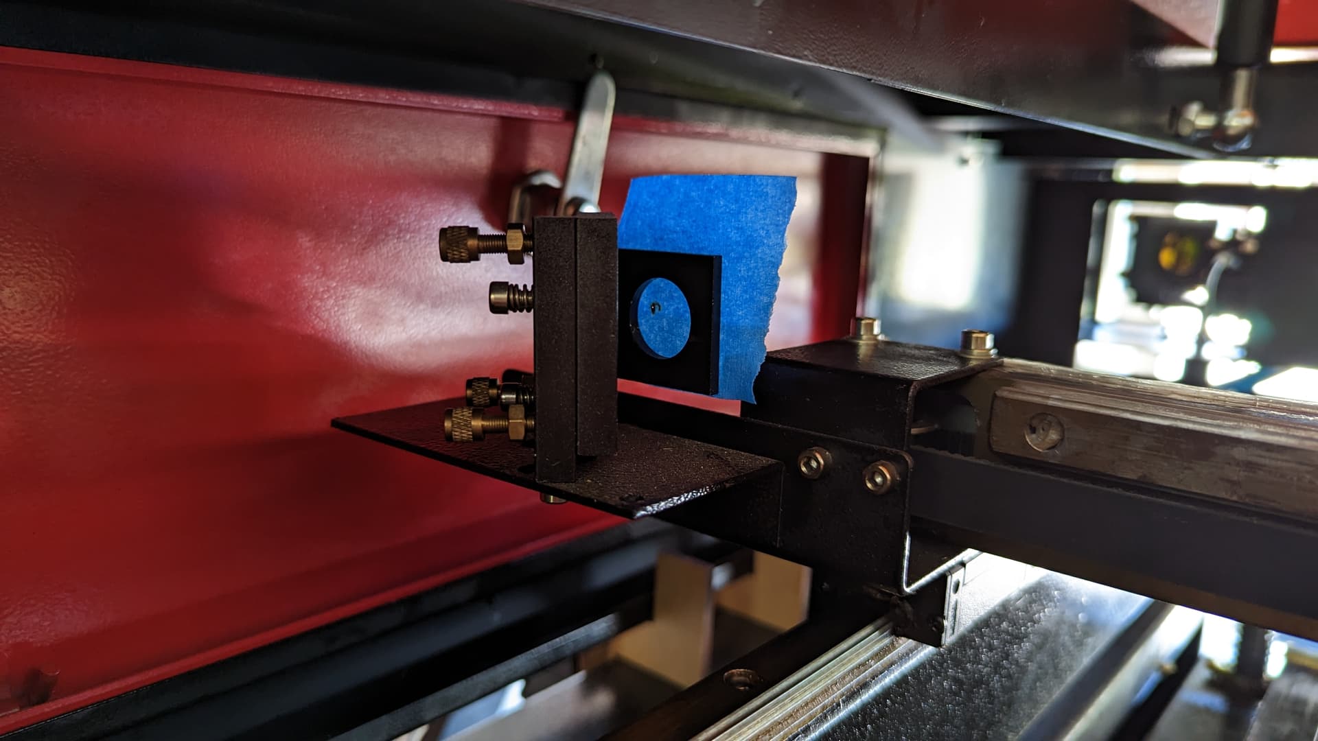

First I move it to mirror 2 and pulse it. It marks the tape decently. I move it to the right position and pulse it 3 times before it even starts to mark the tape weakly. It is consistently showing this loss. This is an 80W Omtech and the power is set to 11%. I noticed originally when trying to cut a large footprint file and it was cut fine on the left but as the head went right on the bed (away from mirror 2) the cuts failed to be made.

I saw another user had this issue but it didn’t appear to be resolved. A few people have recommended it was an alignment issue so I’ve been trying to dial in the alignment for the past week. Here is where it hits on the first mirror:
And this is where it hits on the second mirror:
I am aware that it is off center on the second mirror but that’s just where the two dots are on top of each other and everything I’ve read/seen suggests that its ok here (correct me if I’ve come to an incorrect conclusion).

The problem is either the led/combiner (doubt it) or your tube is going south or has already gone…
The image on the target of the tubes mode doesn’t appear to be TEM00, without that you will never be able to get a useful alignment…

I may be misunderstanding your TEM00 reference. Is this diffraction of the beam in the tube making mine appear more like TEM01? Since I received my machine a year ago when running at low power I have always gotten this kind of pattern but when power is increased it becomes more normal. Should it be consistent even at its lowest (turn on) power?

The purpose of the test it to see what the beam looks like coming out of the tube without any other optics. Your test is clearly after the combiner optics… probably doesn’t matter, but it’s not procedure. If your combiner has a problem, how would we know?
No, but some of it depends on the tube and size… Large tubes seem to lase at a higher minimum than smaller tube… Some 60W tubes from good vendors claim they can run from 12W to 60W… indicating they don’t expect proper operation at less than 20% power…
The tube needs power to properly lase… if you run it so it cannot lase properly, you can damage the gases. You should run it where it’s in TEM00 mode.
This is one of the problems when trying to do delicate work with a large machine. Compare 20% of 80W (16W) to 20% of 40W (8W)… I can do engraving at half the power you can manage and mine will lase well at 10% power, so I could be doing it with power as low as 4W…
