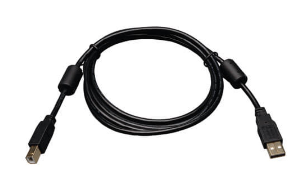

Does your cable have chokes installed? Or, as mentioned a shielded cable might help. In Windows, there is a “power saving” setting for USB ports. Sometimes, depending on how you have power settings, the USB goes to sleep. Here is a cable with chokes:
I have and older Ortur Laser Master 2. There are a number of complaints like yours. Ortur devised a cable to replace the one that came with the unit. The difference being that the new cable grounded the unit. However that fixed mine but I also discovered adding Ferite modules to the USB cable helped. One user said power the laser on a dedicated electric circuit. Or nothing else plugged into the same circuit.
