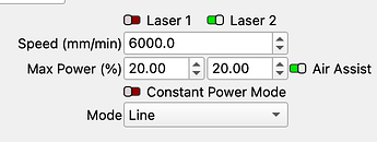

As you know, one way you can currently achieve layer-specific start/end GCode is by leveraging the ‘Air’ assist toggle. But did you also know that the Custom GCode device allows you to use multiple lines of GCode where there might typically been one line previously?
For example, in the example of grblHAL’s ‘Laser Overdrive’ plugin, you could potentially use these lines to:
-change/reduce the air flow using M8
-switch to dynamic power with M4*
-insert commands as needed to activate the plugin such as ‘Mxxx Pxx’
*M3 ‘constant power’ switching isn’t enabled yet in this device.

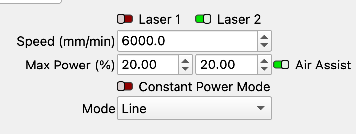

Before I forget, there is another layer-level option which could be repurposed… the “Laser 2” switch, which is enabled by populating the ‘2nd Tool On’ for example:

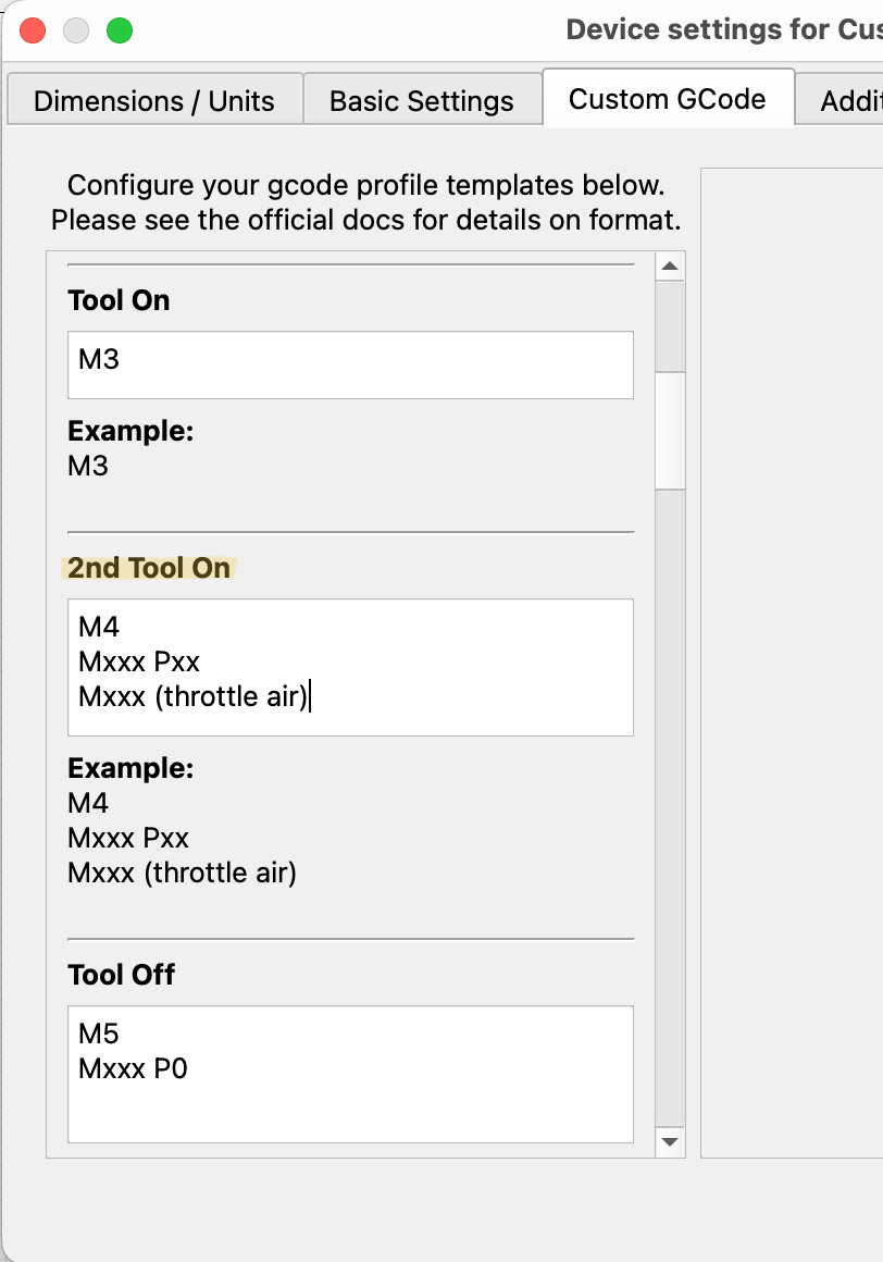

I’m currently trying the custom version of Lightburn.
Using Tool_1 and Tool_2, the “variable/constant power” option doesn’t work… but that doesn’t matter since you can set M3 for tool_1 and M4 for tool_2.
I had some trouble importing the macros and the cut/engrave settings for the various layers, as I couldn’t import from a “normal” version to a “custom” version! I solved the problem by manually copying the macro and layer sections from the export file!
Maybe I’m just not that good at it… but in any case, I solved the problem by doing what I explained.

I have a proposal for you… now I’ll try to explain it to you, thinking out loud…

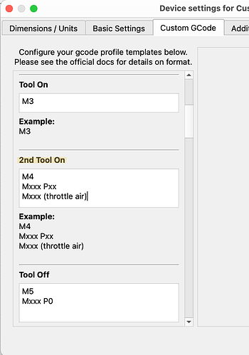

Your advice got me thinking about an alternative solution to my request…
What if in the “custom” version you added (like with the tools) the ability to have multiple types of Air Assist! Let me explain: in the layers window, add the enablement for Air assist_1, Air assist_2, Air assist_3, Air assist_4, etc…
With the ability to edit the text! Example: Air assist_2 → Laser_Overdrive(custom username).
And add the code section in the custom gcode!
This way, in the layers window, you only add the checkboxes to enable/disable the commands and the code remains in the custom gcode page!
It would be like having “macros” that automatically activate when enabled in the layers.
A functional and clean solution! And also easy for users to use…
It doesn’t allow detailed customization for all layers, but it’s definitely a good compromise!
I hope I’ve explained myself clearly with my example…
What do you think of my solution?
I do like the idea of the Custom GCode profile allowing additional checkboxes including “Air” for triggering MCode functions.
Maybe the additional columns could show if the Custom GCode settings for “Air2,Air3” were populated and it would be ideal if the titles could be renamed, but might need to be limited to 4 characters to be tidy.
I don’t think you would need any more than two extra boxes?
