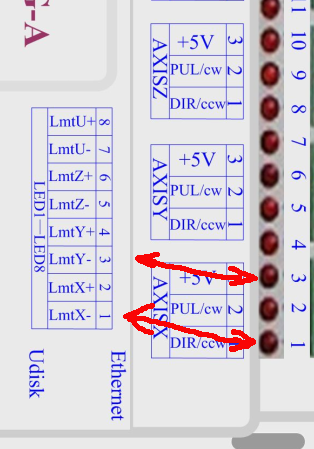

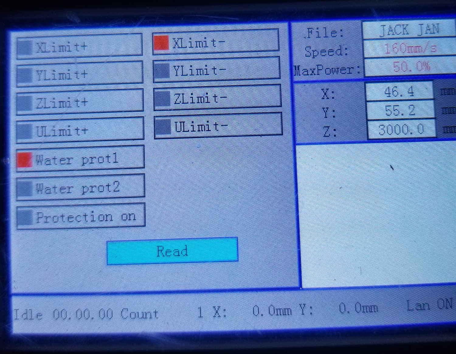

On mine I can bring up a diagnosis menu that shows what the controller it seeing. You don’t mention what controller, mine is a 6442g.
This shows the X home switch and the water protection inputs read active by the controller.
My controller has only two inputs for faults, excluding limits, door protection and water protection for each tube.
Mine also has input leds on the Ruida controller that shows the pins state. There are for the X and Y home function. The door protect doesn’t have an led at this level.
Can you take a photo of the console when it’s failing – hope to spot something…
BOSS Laser Techs were amazing! Traced back all the interlocks and found the hood latch interlock connectors were sloppy!
Did you examine any of the machine console diagnosis, if possible, on your machine?
Did you check the controller for a water protect issue?
