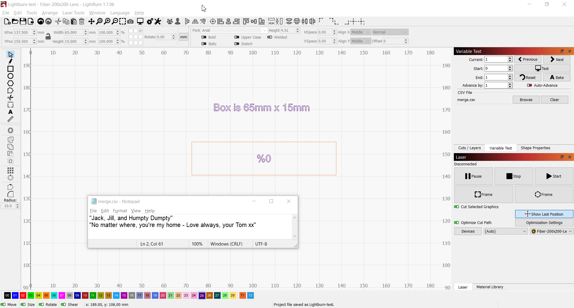

LightBurn_Merge-Sample
Now my biggest issue is “how to word wrap” a text inside the merge text that is coming from the csv :slight_smile:
Please see this gif for what i mean.
LightBurn_Wrap Test
Perhaps it’s the differences among quotation marks:
I think only ASCII double quotes work properly. :slightly_smiling_face:
It’s not quite line wrapping, but you can set up the text formatting to compress longer text into a fixed-length box:
If that’s not enough, then IMO dividing text for presentation is best done manually to split the lines in “good looking” spots.
If the text don’t already require multiple fields, perhaps you can (manually) split the text into two fields:
“Presenting Jack and Jill Sprat feat. Humpty Dumpty”

  • Stack those fields in a text box with a newline between them
  • Turn on Ignore empty variables
  • Enable Squeeze if needed
The first field goes into %0, the second in %1, and LightBurn won’t kvetch about not getting a second field if it’s not there.
