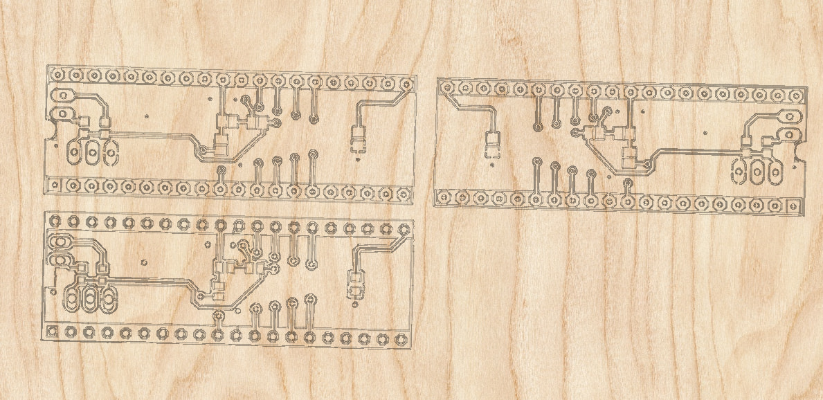

This is part of an R&D for making a couple of 6" PCB’s on the mill. I used Lightburn because I can turn “fill” on and off. I am just stubborn that way. 😁
In the red layer, I do see where there are both blinking and marching sections. Did not figure that made a difference for the Ungroup function here.

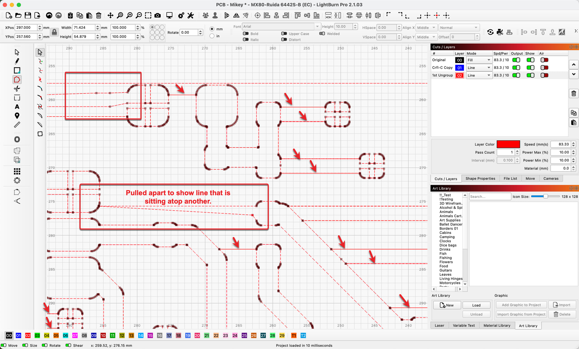

Appears to have lines on top of another. Node edit to see them on the red layer.

I know (blinking segments), but everything selects when I click on any red segment. And Ungroup will not allow selecting any one segment. SVG came from KiCAD.

You can Break Apart and Delete Duplicates…but the output will be different from the black Layer shapes.
In KiCad you can “plot” a better output.

I know it might be too late, but, I repaired the file. Many duplicate lines on the red layer were removed. Also, set the kerf back to zero on the red layer… Works fine now…
