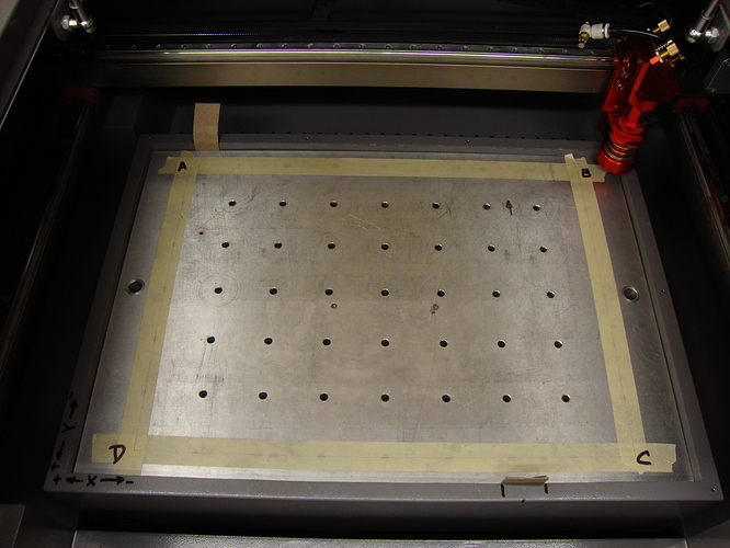

I’m not sure if this is a problem with our Boss Laser 1420 machine (less than 1 year old) and/or a LightBurn interfacing problem. The problem is that markings from the 1st to the 12th part in an array are not centered on the part. The difference is greatest on the Y Axis of 0.020" and is always in the positive direction. The off center is progressive, centered on the 1st part and off the 0.020" total on the 12th.

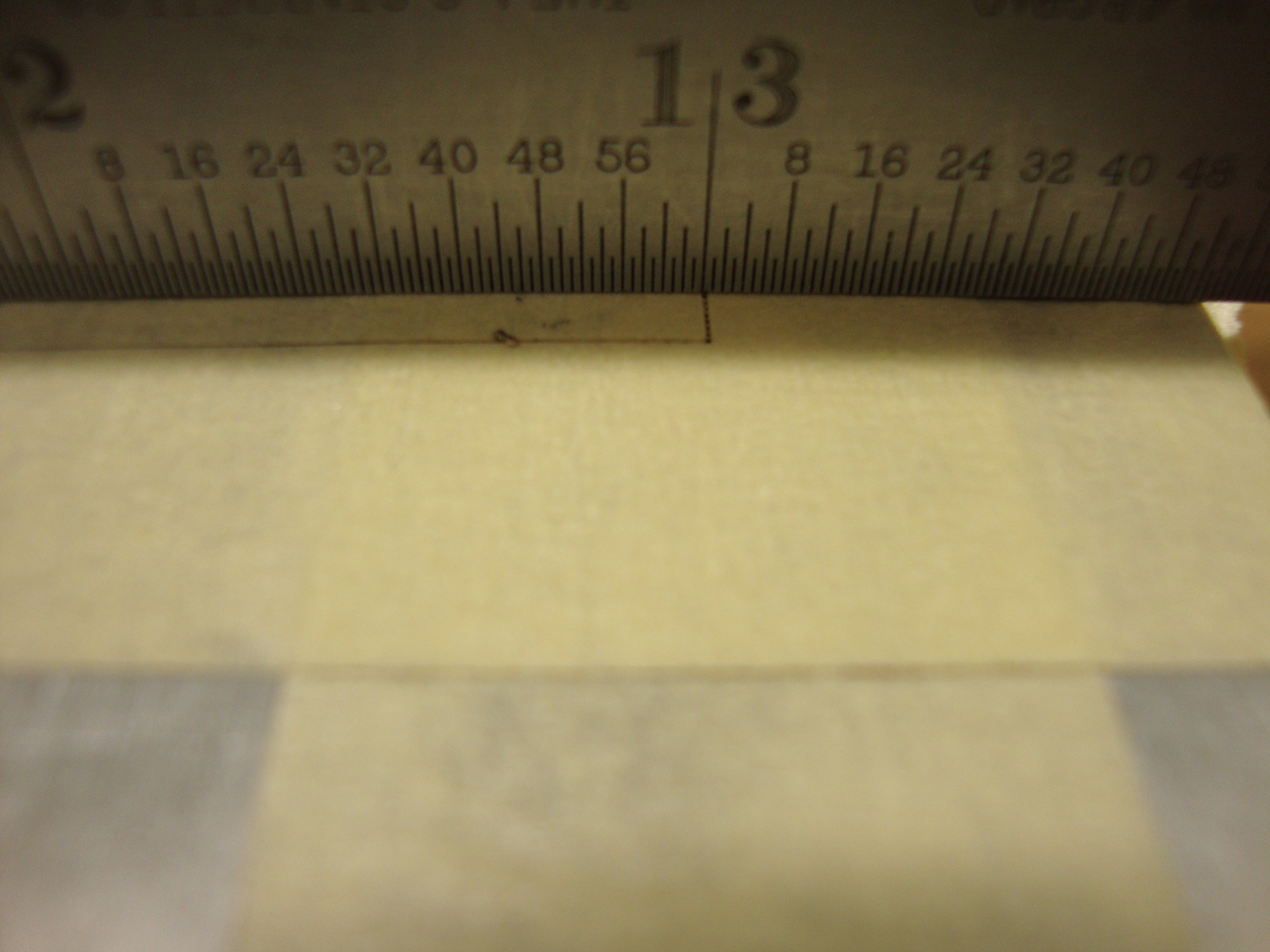

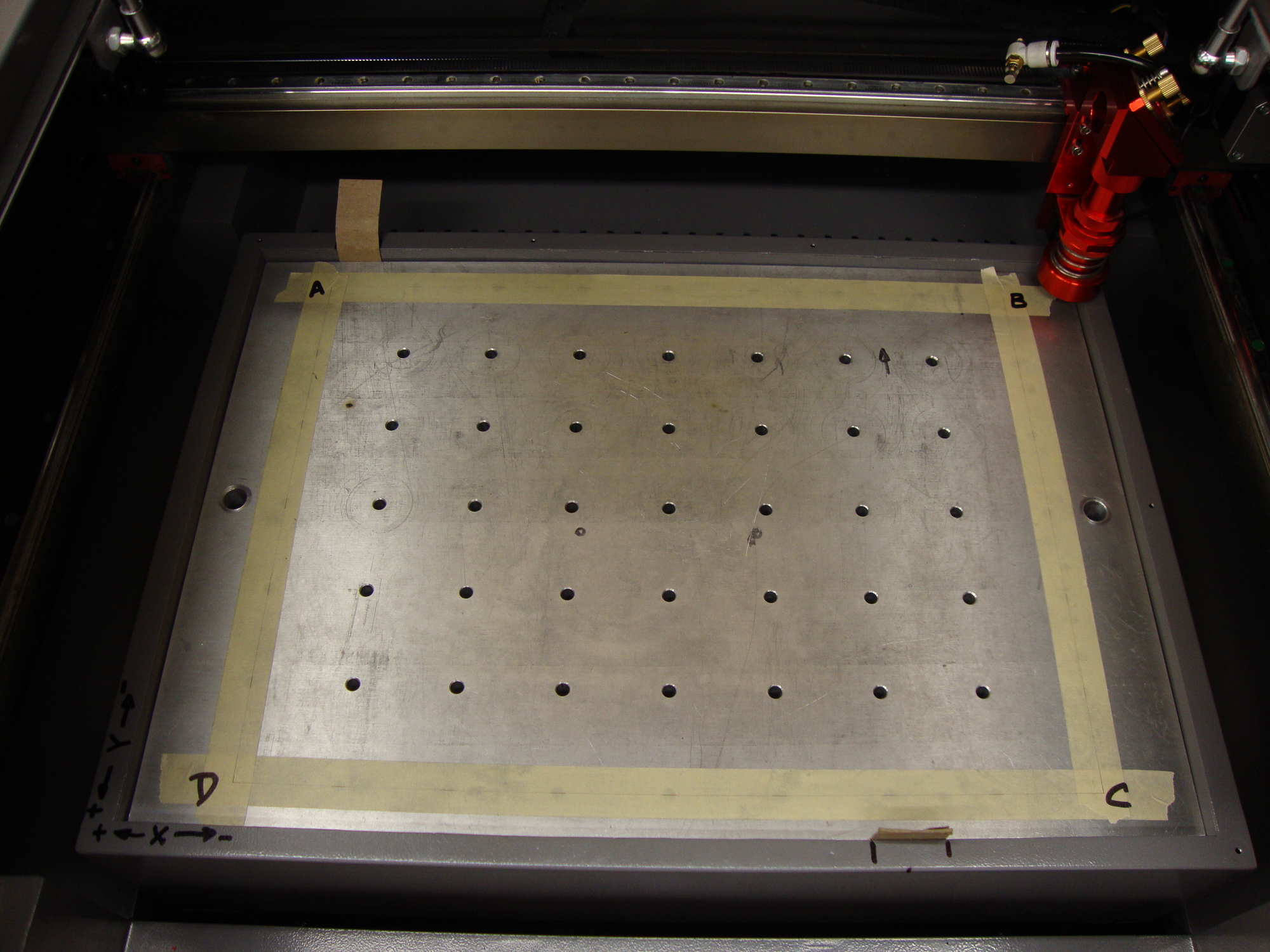

I marked a 12" x 16" rectangle. The 12" (Y Axis) is off approx 0.007" and the 16" (X Axis) is off approx. 0.015". Across corners of the rectangle is within 0.030". One image shows the corners identified. Between A & C the measurement is approx. 21.000", between B & D the measurement is approx.21.030". Looks more like a parallelogram than a rectangle.
*We also tried marking one part at a time, the markings drifted off center of the part approx. 0.020" within 6 parts.*Can I make the changes to the machine parameters to correct for these errors?
