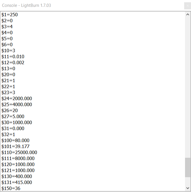

$100 =80.000
$101=39.177 As suggested by Fox Alien for there roller.

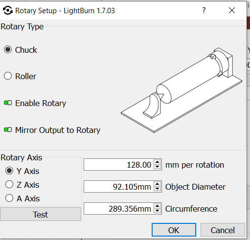

Additionally, I also typed in the bottle circumference in the distance window for the move function in LB for a 360deg test, when arrow clicked the travel was less than 360
CIR =289.000mm, result was 28mm short
to get a full start to end point, the distance had to be set to 327mm for a full rotation.

Set $101 back to what it belongs. 80? Take a screenshot of the rotary setup screen. Please take an actual screenshot rather than a photo of the screen. The glare and moire make it difficult to see.

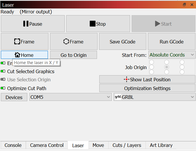

For instance, If I run my machine in the GRBL setting in the laser device setting? My machine homes but loses the control function, when moving the gantry. Homes fine, but I don’t have full range of motion.
In GRBL-M3 I Lose the continuous operation but have full range of motion.

With the rotary installed I disable homing. Enter $22=0
Your $30 is 80000? I have never seen one at that. It’s usually 1,000 or 10,000. Does your S-Value Max match that in Lightburn?
According to Xtool the RA2 is supposed to be set at 128 mm per rotation. You are set at 360, which would explain the multiple turns.

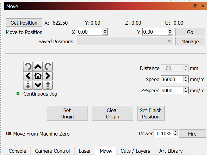

In the Rotary set up page Jus checking functionality using the test button in LB the Roller operates ok, but when jogging the machine the roller only goes in one direction, regardless of the arrow pushed.
So in the Move window, forward on the Y axis works, If I click back towards me? the rotary rotates forward not back to the front.
Another issue is When going to right it flies to the right but won’t go back to the left when requested. but will return to the left once home is requested.

When you use the test button does the chuck rotate 1 complete turn and then back to start?
I note that you have fast whitespace scan enabled but a speed of 0, either disable that or set a speed of 3,000 or so. Don’t know if that will solve your problem, but it isn’t correct like that.
Is this a different laser? Before you were working with a laser head on a CNC machine, correct? Has this setup ever worked?
Changed the fast white scan to 3000. No change as in functions.
This is a new machine, with the same issues as the CNC, before leaving for the holiday.
The chuck does not rotate 360, it appears to be close to 90.

In the console window this is what it shows after trying to go the different directions.
<Idle|MPos:-622.500,-97.608,0.000|Bf:127,65535|FS:0,0|Pn:X>
ok
ok
Starting stream
Stream completed in 0:00
ok
<Idle|MPos:-622.500,-96.613,0.000|Bf:127,65535|FS:0,0|Pn:X>
ok
ok
Starting stream
