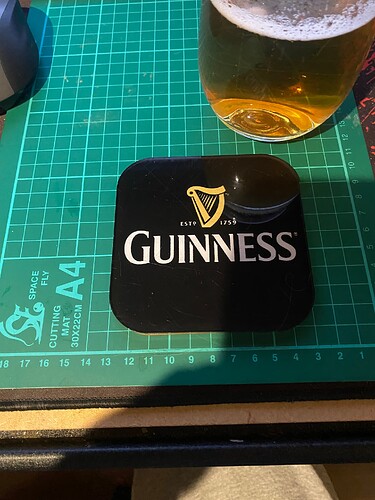

Hi Dennis,
I have some experience working with Trolase. What I found to work best is to engrave it out of focus and setting the line interval as high as I can. You want the engraving to be transparent and as smooth as possible.
This is a coaster I made from Trolase Reverse a couple of years ago.
