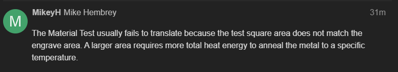

No.
The Material Test usually fails to translate because the test square area does not match the engrave area. A larger area requires more total heat energy to anneal the metal to a specific temperature.

3
I get that, but the tests I have done are all on the same material, at the same size ..
The results from the Material Test, do not carry through to the Project results.
