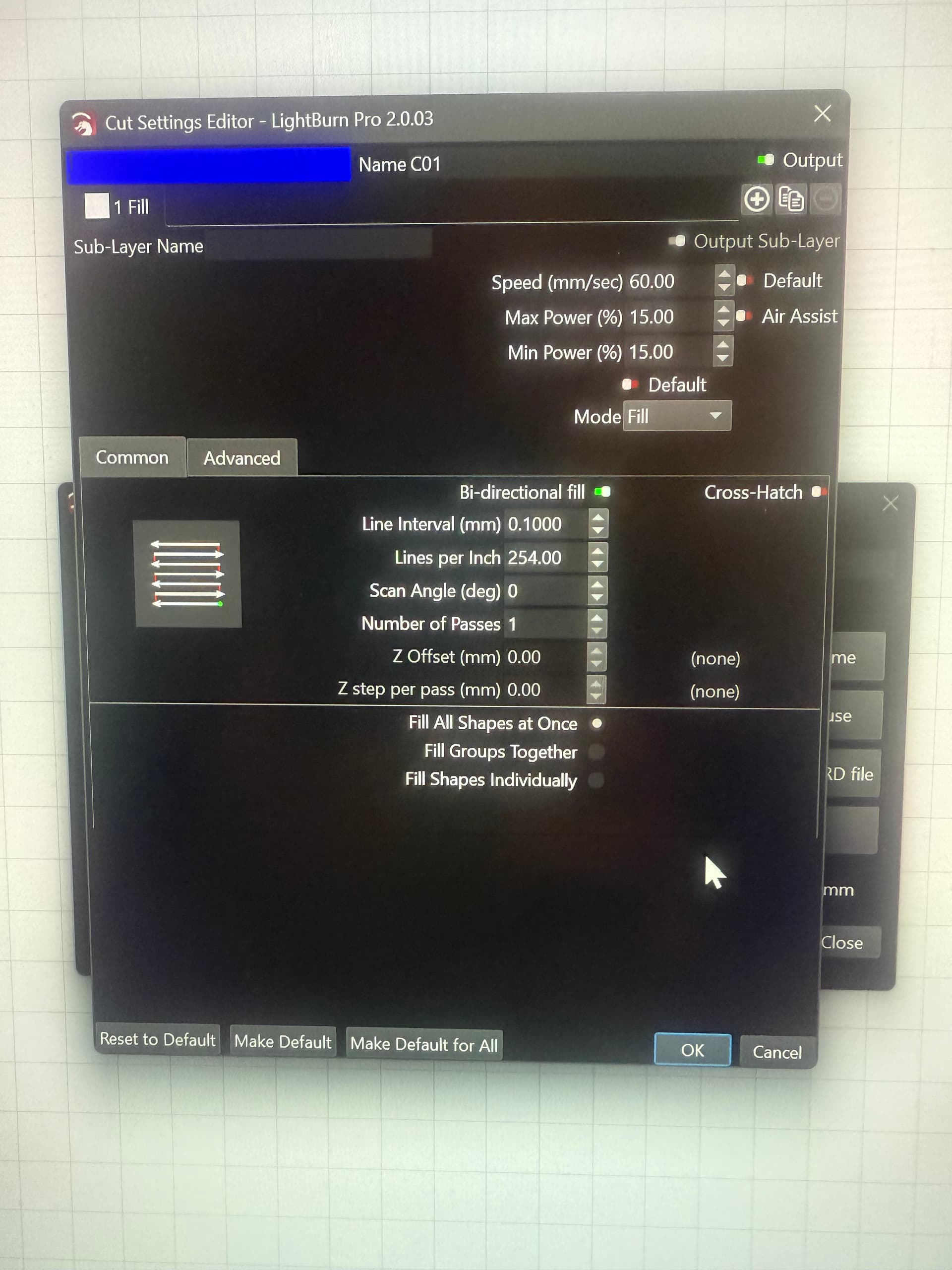

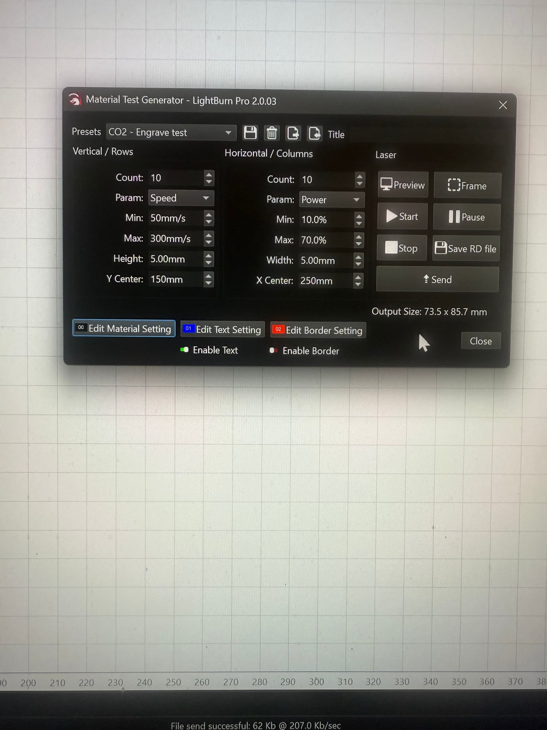

When I tried to do a Material Test, after my fubar of blowing the fuse very spectacularly, now I get a “File Invalided” when I try to pull up the file and locks my controller up, on my CO2 50w Laser.
I did a search on the forum and the only reference to this was back on version 1.0.xx that said they were fixing on the next release, long ago so it was not very relevant.
Everything that happened since my last successful material test;
  1. I updated Lightburn to the latest patch.2.0.03. I see no issues with the update, so ruling this out.
  2. I was drilling a hole in the side and shorted out and blew the fuse, big time. But everything I do and files I have ran still run fine. I am only having the issue on Material test.
  3. I have set the material test back to defaults. I seem to think it is something in the settings.
  4. I have been successful, using the Ruida Ethernet controller
Perhaps someone can see an issue in the settings, give recommendations

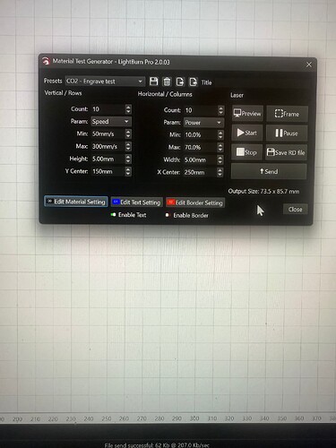

We’re going to file this to ID10T error, I guess you need to save RD file first them send it to laser. Go figure.
