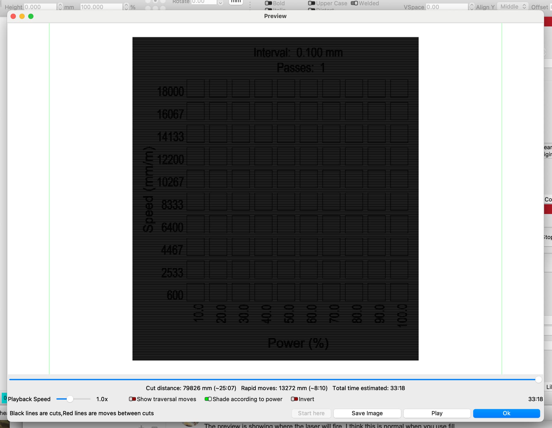

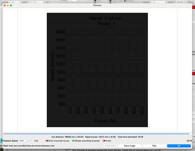

I’m trying to do a material test on my Sculpfun iCube but when I preview it in Lightburn it looks like an almost solid black image. I’m using the built in material test generator. I’m sure I must have something not setup right…any pointers?
In the test generator screen, go into edit border settings (at the bottom) and switch to line instead of fill.
Fantastic, that did the job…much appreciated
And be aware that the speed values don’t match the iCube’s capabilities.
Thanks for the heads up :+1:
