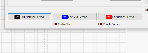

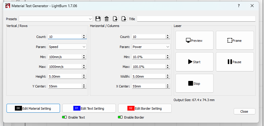

The generator for testing materials does not change the red outline when turning off the outer contour and text. the outline by size remains the same. Is this a problem for me or does everyone have it? If it is for me, then what should I do correctly? Because a lot of material is lost, and it is expensive. I have to constantly turn off the generator, set the outline of the rectangle of the required size, then turn on the generator again. This slows down the work a lot. Thanks

I agree with Sergey, it would be nice if when you disabled “Enable Text” and “Enable Border” if they didn’t outline when framing. Trying to squeeze out as much test area as possible on small oddly shaped samples so testing on a piece of cardboard doesn’t help much. Also, positioning isn’t saved when you save a test parameter which further frustrates the situation.

Sorry, I think you didn’t understand the problem. We are talking about the built-in test of materials. You don’t need to prepare a separate file for it. Everyone who has the program has it.
I would love to see Material Test Generator get a “Save as LightBurn” option and/or a “Insert” button to simply put the Generated Test on the Canvas, then it can be modified, combined and laid out (even with a camera) just how users want
