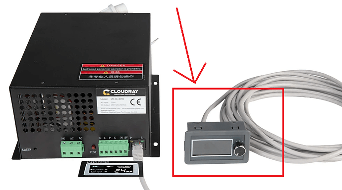

![psu150](https://forum.lightburnsoftware.com/uploads/default/original/3X/f/5/f563da649f92a82b70b590b2e1d5374d70e28e7e.png)

> **[Cloudray LCD Display Current Meter For MYJG 100W&150W](https://www.cloudraylaser.com/collections/co2-laser/products/cloudray-lcd-display-current-meter-for-myjg-100w-150w)**
> LCD Display Current Meter For MYJG 100W&150W Laser Tube & Power Supply,Clouday,CO2 Laser,Cloudray LCD Display Current Meter For MYJG 100W&150W,MYJG,100W,For RECI Laser Tube

yes that appears to be the display that is used on the power supply on my laser. What I am trying to do is calibrate the mA output vs the % power in lightburn. With the 130w H6 tube I have, 100% should be 30mA. I hit that at 60-65%. However it can easily go higher, as when doing a power scale test (multiple lines at increasing power levels) I aborted the test when it hit 34mA (about 75 or 80% in LB). So I would like to have a way to set everything so that 100% in LB is 30mA or so.

A max power limit, scaled to 0-100%, from LightBurn itself will be very welcome with many users. I think this topic has been up here in the forum before but, the feature could not be implemented in LightBurn for “technical” reasons. (if I remember correctly!) There was always reference to the small potentiometer in the power supply itself which can adjust the output max. But not all power supplies have this function and I personally will never stick a piece of metal through a small hole in a high voltage power supply to, (without seeing anything what I am messing around with) adjust the output power.
I doubt if “Cloudray LCD Display Current Meter For MYJG 100W & 150W” can limit max power output in that it is not programmable. It is probably more intended to adjust the current output power in mA for the performing task with the laser, but the range is probably 1-99% of the power supply itself.

Hello
this device will be adjusted without you going with a screwdriver on the box you send the program at 100% and you turn to have 30 ma displayed

It might be worth checking. But the trim pot on my psu is not located under the hole marked laser. My trim pot is accessed thru a hole on the side of the power supply and its pretty easy to adjust if you have a meter installed.

Hello
I bought this controller to avoid putting a screwdriver in the hole given the price of this controller we gain in security
put the laser on 100% and turn the lever to bring the meter to 30ma
and here you have settled the 100%
